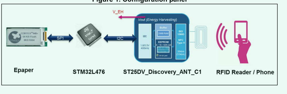

I want to know how to show how to use the energy harvesting feature based on the ST25DV-I2C-04K in combination with an STM32L476 MCU.I have noticed that there is a code named EH energy collection, can you power L476 to make it run normally?

I think 47.1mW could be too much power, and you also have to add the power requiered by the STM32.
If you look at the curves in the application note a I recommended in a previous post, you can see that EH will not deliver more than 30mW in best conditions.
But I think the best is for you to try. Maybe the MAX6675 is consuming less than the 47mW (this may be a maximum in some high temp conditions).
Best regards.
2023-05-24 12:38 AM
Yes, it would be possible to power a STM32L476, but with some conditions.
ST25DV is able to deliver at best 20mW of EH, and only in best conditions.
Best conditions means a good coupling between readers antenna and tag antenna (larger antennas are better). The reader need to be powerful enough (don't expect to do this with a smartphone, a dedicated reader is needed like ST25R3911 or ST25R3916).
Usually, a tank capacitor of a few uF helps a lot with current surge peak.
The STM32 must be configured to consume the less power possible and Vdd should be as low as possible (1.8V is ok).
Best regards.
