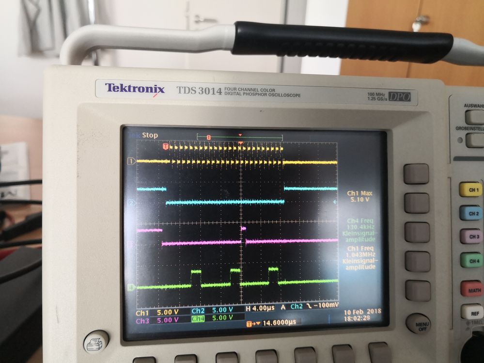

}For better understanding I add a picture of the SPI Communication.
In the Picture:
yellow: SPI_CLK
blue: CS
red: MOSI
green: MISO
Can someone help me why the Chip is not responding?
