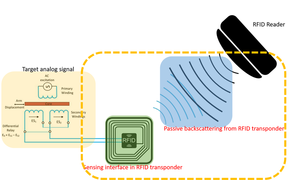

hello want to sense some analog signal with passive mode
does ST25 able to work with passive mode?
since i know that many researchers prefer ST product because of fidelity,
really want that want to run project with ST products.
can you help me with finding the right model that im looking for?
the thing im trying to find now is,
1. RFID transponder tag
2. Passive mode availability
3. Sensing interface
that is the all the features what im looking for now.
Will attach image for better understanding
the sysmtem in orange box is the thing all i need
does ST25 is possible to make that system?
really appreciate for sharing your time with my post
thank you very much

2020-10-26 7:43 AM
What are the required parameters of sampling the analog signal?
It will be tough to achieve this with an RFID transponder only, as you will need some intelligence to capture and transfer the aquired data. You could solve this problem using a Dynamic Tag instead
This is difficult to achieve with just an RFID transponder as you will need some intelligent device in order to capture and transmit the captured data. You can solve this problem with a Dynamic Tag Instead, e.g. the ST25DV04K, which is based on ISO/IEC 15693, also includes a buffer with 256 bytes and an I2C interface to do fast data transfers, as well as an energy harvesting block to supply a connected microcontroller. The NFC device (tablet, smartphone, dedicated reader) emits the RF field, which provides the power for the harvester and the data communication.

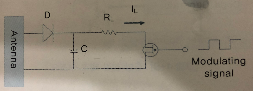

2020-10-26 10:27 PM
2020-10-26 10:27 PM
Really appreciate the swift response.
i totally understand that, without electrical power for the rfid transponder circuit, it is tough to achieve our goal.
so then, one question I have with is, when reader makes incident electromagnetic field, in order to communicate with RFID transponder,
is it possible to active (make enough power to turn on the) IC chip in the transponder by making an rectifier or something like that (pic #1)?
or should we have to consider another way to solve the power consumption problem (for example battery).
So far, I thought the only thing I had to consider was, design of the antenna, and choosing the RFID transponder IC chip (pic #2). but seems apparently not.
Would you mind if I ask you to give me a little help to verify that your products are suitable for our purpose or not?
i mean does incident field from a reader can activate the IC chip? or should i have to consider about the power consumption for the RFID transponder side as well?
2020-10-27 1:20 AM
Yes, the field from the reader can power both the Dynamic NFC Tag as well as a connected microcontroller and maybe also your analog circuitry. But please keep in mind: the energy you got from the harvester is very limited and requires some ultra low power design.
