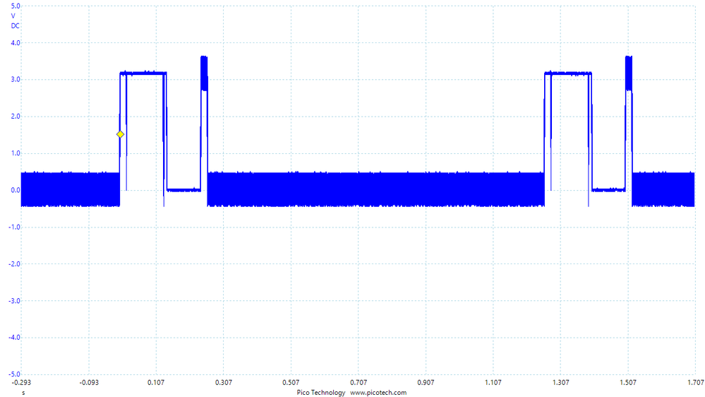

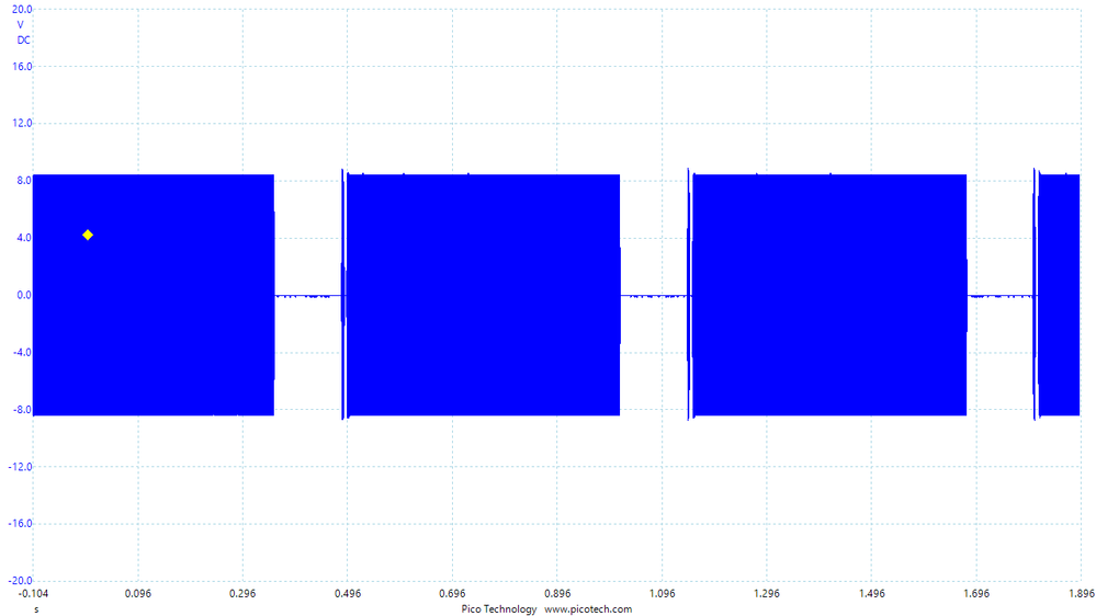

Attached figures is the IRQ and the output of RF carrier. Are they normal?0693W00000QOG8mQAH.png0693W00000QOG8cQAH.png
Best regards
Dai Sai

By checking the return value of rfalFieldOnandStartGT(), the return value is ERR_INTERNAL(12U).
I wonder if the return error should be checked at current stage?
best regards
Dai Sai
Brian TIDAL
rfalFieldOnandStartGT should return ERR_NONE. I suspect an issue in the adaptation to the threadX platform, likely in the timer management.
I would suggest to enable ST25R_SELFTEST and ST25R_SELFTEST_TIMER as global defines in the compiler command line. Then check the return code of st25r3916Initialize called in rfalInitialize.:
  • ERR_NONE: interrupt, timer and serial communication with the ST25R3916 are OK
  • ERR_IO: serial communication issue (likely not the case here)
  • ERR_TIMEOUT: interrupt management issue
  • ERR_SYSTEM: timer issue (my best guess)
Rgds
