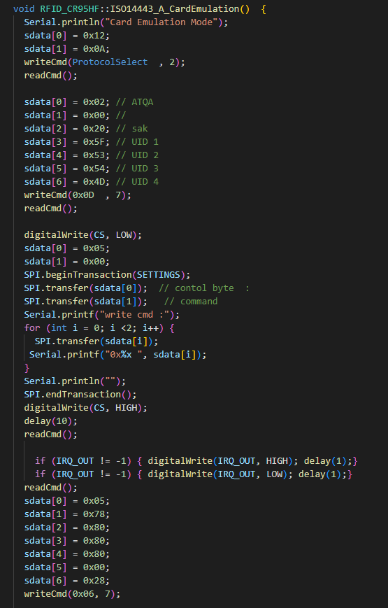

I will provide you with the Arduino code I wrote, so I would appreciate it if you could help me implement the CR95HF card emulator mode.

void RFID_CR95HF::writeCmd(unsigned short cmd, unsigned short dataLen) {
unsigned short i = 0;
digitalWrite(CS, LOW);
SPI.beginTransaction(SETTINGS);
SPI.transfer(0x00); // contol byte :
SPI.transfer(cmd); // command
SPI.transfer(dataLen); // length
while (dataLen == 0) {
digitalWrite(CS, HIGH);
break;
Serial.printf("write cmd :");
for (i = 0; i < dataLen; i++) {
SPI.transfer(sdata[i]);
Serial.printf("0x%x ", sdata[i]);
Serial.println("");
SPI.endTransaction();
delay(10);
// Poll the CR95HF
void RFID_CR95HF::readCmd() {
while (1)
SPI.transfer(0x03);
res = SPI.transfer(0);
//Serial.printf("==== Read cmd :");
for (i = 0; i < dataNum; i++) {
rdata[i] = SPI.transfer(0);
// Serial.printf("0x%x ", rdata[i]);
if ((res & 0x08) >> 3) {
SPI.transfer(0x02);
dataNum = SPI.transfer(0);
Serial.printf("Read cmd :");
Serial.println("");
break;
delay(10);
Function usage is as follows
<example card emulation mode packet >
sdata[0] = 0x12; // data 0
sdata[1] = 0x0A; // data 1
writeCmd(0x02, 2); // protocol select cmd, length SPI write
readCmd() // SPI Read

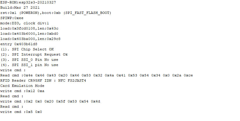

<debug result>
2022-08-17 12:35 AM
please use a logic analyzer and verify the sequence against the one provided by Brian. If it still doesn't work please provide the logic analyzer traces.

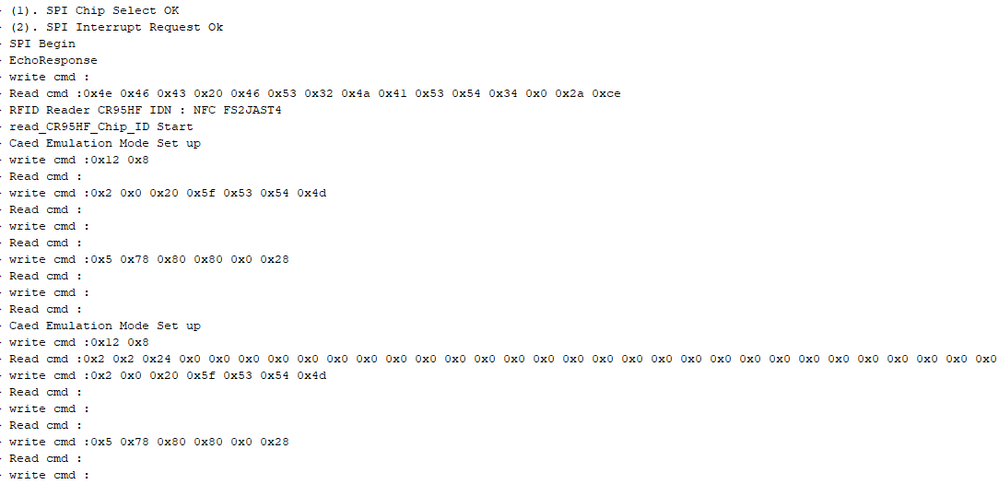

hard to follow your sequences. Please write full sequences as described by Brian and please use a Logic Analyzer to follow the timing of your commands as well.
Best Regards, Ulysses

This is the order in which my code works
1) slave(CS) pin Low -> SPI Setting() -> packet Tx : 0x00 (control byte), 0x55(ECHO cmd), 0x00 (len)
-> slave Pin High -> SPI.endTransaction
※Tx packet : 0x00, 0x55, 0x00
2) slave(CS) pin Low -> SPI Setting() -> SPI transfer() packet Tx : 0x02(control byte), 0x00 -> slave Pin High
->SPI.endTransaction
※ Tx packet : 0x02, 0x00
4. Read Chip ID (CR95HF)
1) slave(CS) pin Low -> SPI Setting(); ->SPI transfer() packet Tx : 0x00(control byte), 0x01 (IDN cmd), 0x00(len)
※Tx packet : 0x00, 0x51, 0x00
2) slave(CS) pin Low -> SPI Setting(); -> packet Tx : 0x03(control byte), 0x00
-> slave Pin High -> SPI.endTransaction -> for( i=0; i<data; i++) save[i] = SPI transfer(); packet Tx : 0x03,
0x00
※Tx packet : 0x03, 0x00 after -> if (SPI transfer & 0x08) -> slave(CS) pin Low -> SPI Setting(); -> packet
Tx : 0x02(control byte), 0x00 -> for(i=0; i<data; i++) rdata[i]=SPI transfer(); -> slave Pin High
※Tx packet : 0x02, 0x00
※Rx packet(rdata[]) : 0x4e 0x46 0x43 0x20 0x46 0x53 0x32 0x4a 0x41 0x53 0x54 0x34 0x0 0x2a 0xce
result : RFID Reader CR95HF IDN : NFC FS2JAST4
5. Card Emulation Mode Set up
1) select protocol
Tx packet : 0x00 (controlbyte), 0x02(protocol select cmd), 0x02(len), 0x12, 0x08
rx packet : 0x00 should be returned if read normally, but no actual value is returned
2) AC filter
Tx packet : 0x00( controlbyte), 0x0D(AC_filter cmd), 0x07(len), 0x02, 0x00, 0x20, 0x5F(UID), .0x53(UID),
0x54(UID), 0x4D(UID)
Rx packet : 0x00 should be returned if read normally, but no actual value is returned
3) Listen : I wrote a write code, but this part is not written :sad_but_relieved_face:
Tx packet : 0x00(controlbyte), 0x05 (listen cmd), 0x00 (len)
Rx :0x00 should be returned if read normally, but no actual value is returned
4) Tag Send
Tx packet :0x00(control byte), 0x06, 0x06, 0x05, 0x78, 0x80, 0x80, 0x00, 0x28
Rx : 0x00 should be returned if read normally, but no actual value is returned
I've written it up to here

void card_Emulation_14443A(void)
Serial.println("Caed Emulation Mode Set up");
sdata[0] = 0x12;
sdata[1] = 0x08;
writeCmd(ProtocolSelect, 2); // Card Emulation Mode Tag type select 14443A
readCmd();
sdata[0] = 0x02; //ATQA
sdata[1] = 0x00;
sdata[2] = 0x20; // sak
sdata[3] = 0x5F; // User Tag UID
sdata[4] = 0x53; // User Tag UID
sdata[5] = 0x54; // User Tag UID
sdata[6] = 0x4D; // User Tag UID
writeCmd(AC_filter ,7);
readCmd();
writeCmd(Listen ,0);
readCmd();
while(!EchoResponse()) {
if (IRQ_IN != -1) { digitalWrite(IRQ_IN, HIGH); delay(10);}
if (IRQ_IN != -1) { digitalWrite(IRQ_IN, LOW); delay(10);}
readCmd();
sdata[0] = 0x05;
sdata[1] = 0x78;
sdata[2] = 0x80;
sdata[3] = 0x80;
sdata[4] = 0x00;
sdata[5] = 0x28;
writeCmd(Tag_Send ,6);
readCmd();
readCmd();

I think you will need a logic analyzer in the end. Changing the low level/porting will require looking at signals (SPI+IRQ_IN+IRQ_OUT, etc.) and timing. If you are lucky then you can get it working without but experience is that often there are subtle problems in SPI, IRQ handing, timing which cause it not working.
Of course you can go, create hypothesis of what could be the reason or what is happening, change something here and there and you may get it working. But a logic analyzer will tell you straight away what is happening and removes a lot of guessing.
There are inexpensive USB based logic analyzers, please get one!
