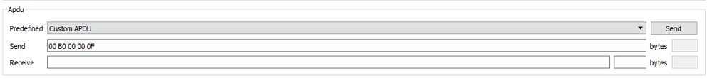

I'm trying to call the ISO-DEP command that you demonstrate in your GUI to send through custom APDU's to the ticket once a connection has been established.
0693W00000Lz0x5QAB.pngI assume i tried to do this previously but was unsure what to set for the parameters uint flags, uint fwt
Thanks in advance for any help you can provide in this manner.
