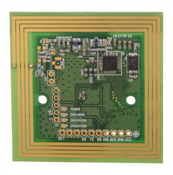

I need the suggestion such that in my PCB layout, I am trying to put all the RF chip and components will be at center of the antenna. So that I can get more space. If I seen the CR95HF Eval board the antenna part is separate and no other components also placed at the bottom and inside the antennal tracks.
This above type of placement is recommended?
Will you share the PCB guidelines for the CR95HF...

2021-09-20 7:01 AM
see https://community.st.com/s/question/0D53W00000THvKbSAL/how-to-increase-the-range-of-cr95hf-receiver-on-a-custom-pcb for similar question and for reference on Application notes and various recommandations
Rgds

2021-09-21 12:02 AM
Will you share the PCB file of the X-Nucleo_NFC03A1 & M24LR Discovery Kit. I got only the Gerber file in the website.

2021-09-22 5:09 AM
CAD files sent in private message

Thanks....
i got the files..
Kind Regards,
