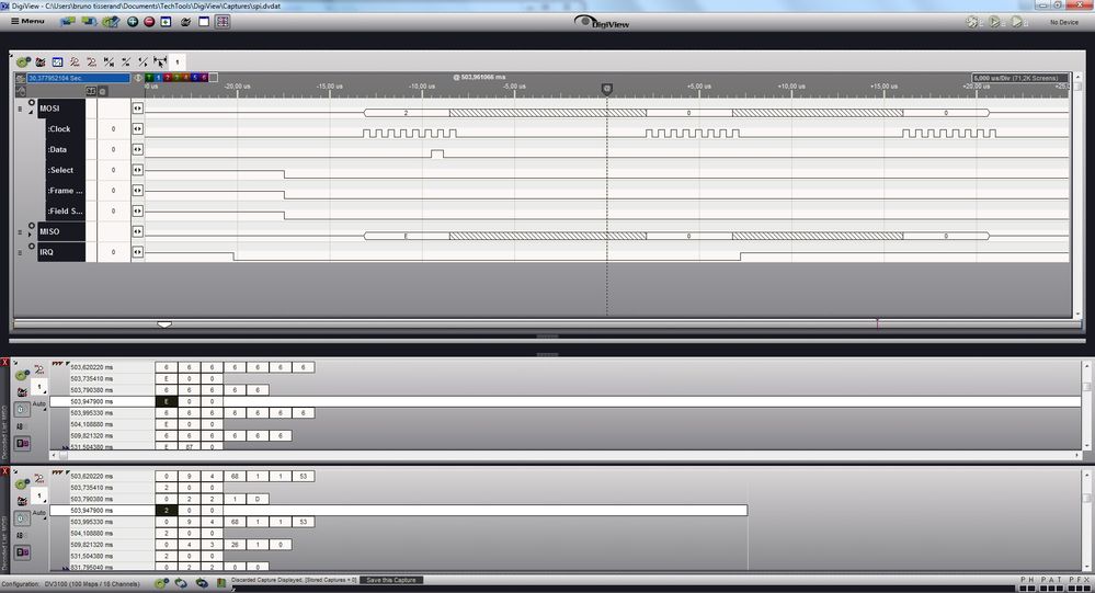

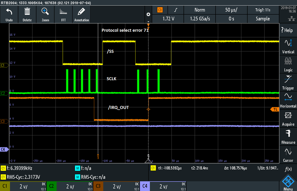

I have a CR95HF transceiver connected over SPI interface running at 2MHz. When I send the protocol select command I get the error 0x71 (EinternalError) .
The IRQ_OUT goes after the 4-th byte low .
Clock, MISO, MOSI looks ok.
Send data 00 02 02 01 0d
Get data 0E 71 00

2019-01-04 10:09 AM
Hi Gaby
In your first screen capture, the IRQ_OUT goes low before the end of the frame whereas it should goes low after the reception of the full frame. So it seems there is a transmission error on the first bytes and the CR95HF reacts immediately and send an error response.
Would you please make sure that your SPI clock frequency is not exceeding CR95HF max value (2.0 MHz).? On my side, I use a lower SPI clock frequency (~1.5 MHz) with an X-NUCLEO-NFC03A1 expansion board and I do not face communication issue. Would you please try a lower frequency than the 2.0MHz limit (e.g. 1.5 MHz) ?

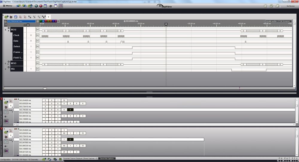

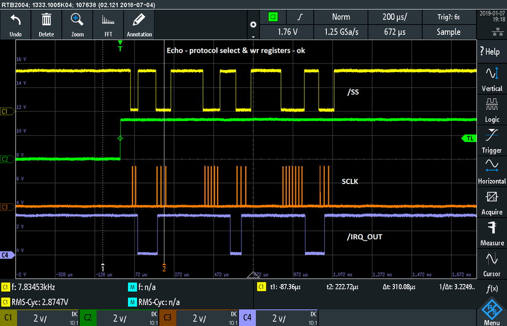

I changed the start sequence:
/IRQ_IN pulse
delay
echo command
get echo answer
select protocol command
get answer
write registers command
get answer
In this way it works.
Attached some fotos, maybe it will be help somebody else :)
