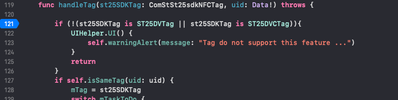

In specific, I get problem with following code in from "ST25DVMailboxManagementViewController"
The following condition fails in my code, but succeeds in iOS NFCTap App.
if (!(st25SDKTag is ST25DVTag || st25SDKTag is ST25DVCTag)){}
Did anyone face something similar?
Any leads will be greatly appreciated.

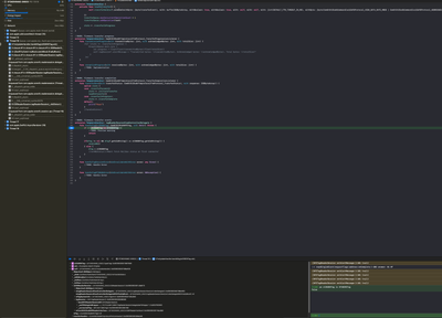

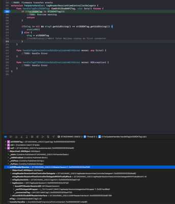

Here I have also attached my debug window. (My goal is to only be able to activate mailbox.)

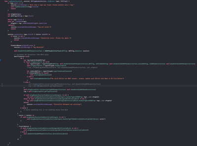

p.s: I have also attached code segment for clarification.
My Tag handler:
iOSReaderSession

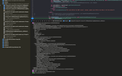

Sure, I have attached the debug log here,
Please let me know what you find:
Thanks in advance.

I see that your ProductId is still set to ProdutUnknown.
Please, check that functions for tag identification are called correctly into your code. ref to previous post above.
