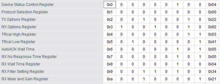

Using the defautl configurations of the FEMTO, as follow:
In order to start reading a tag. I first write the values above in the registers, then I enable the bit RF_ON on register 0x00.
After send the Query command 0x98 and write the following bytes to the FIFO:

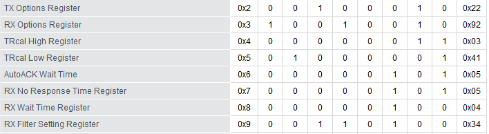

I am using the following values to set a session to try read a tag:
Register Description Address Value
After that I try to read a tag by doing the following:
1 - Set the register 0x3E with 0x1E - Sending 1 byte and 7 bits to FIFO
2 - Send the Query command - 0x98
3 - Write 0x30 0x00 in FIFO
4 - Aftet that I detect the end of transmission interrupt
5 - I wait for the end of reception interrupt
But I detect the values 0x01 in register 0x38 (Preamble detect error / FIFO overflow error) and 0x50 in register 0x37 (Bits Irq_err and Irq_rx high ). I was expecting to detect only Irq_rx high.
I have no idea what I am doing wrong.
