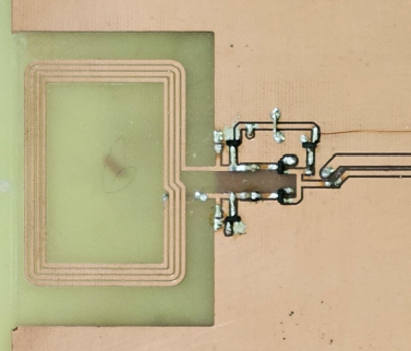

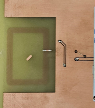

I'm implementing a children's game board with 6 spaces to place nfc tags with 6 antennae multiplexed as described in AN6121 - which is a great application note and ideal for what I'm doing! I've done rf and speed layout before but not anything for NFC and I'm a bit confused by a couple of things:
- looking at the photos of the board in AN6121 there seems to be a thick and thin trace going to each antenna, and also a thick trace on the back of the board, none of these look like a differential trace to me, is it just not that critical in this application or am I missing something here? I wondered if the thick traces on opposite sides of the boards were matched to each other?

1.) looking at the pictures, both traces seem to have the same thickness (after the selection circuit), as i would do and recommend it:
Bottom:
Top:
2.) Correct, but since NFC is basically DC (13.56MHz) compared to BT, WiFi, UWB or mm wave, it is not super important. The wavelength of NFC is around 22.1 meter.
3.) The ST25R NFC readers are outputting a square signal at their RFOs. The EMI filter is then filtering it and damps higher harmonics of the spectrum. It means that after the EMI filter, mainly the 13.56MHz frequency is present. I think my colleague put one trace on top and one trace on the bottom layer to have them as close as possible together, minimizing radiation. Also due to the prototyping approach, we have been limited to 2 PCB layers only.
The AN can be seen as a proof of concept and does not perfectly implement all use-cases. Some applications may require that the switching circuit is located close to the ST25R, others can put it directly in front of the antenna.
I think you have made some good and correct assumptions which are worth to be implemented if the application allows it.
BR Travis
