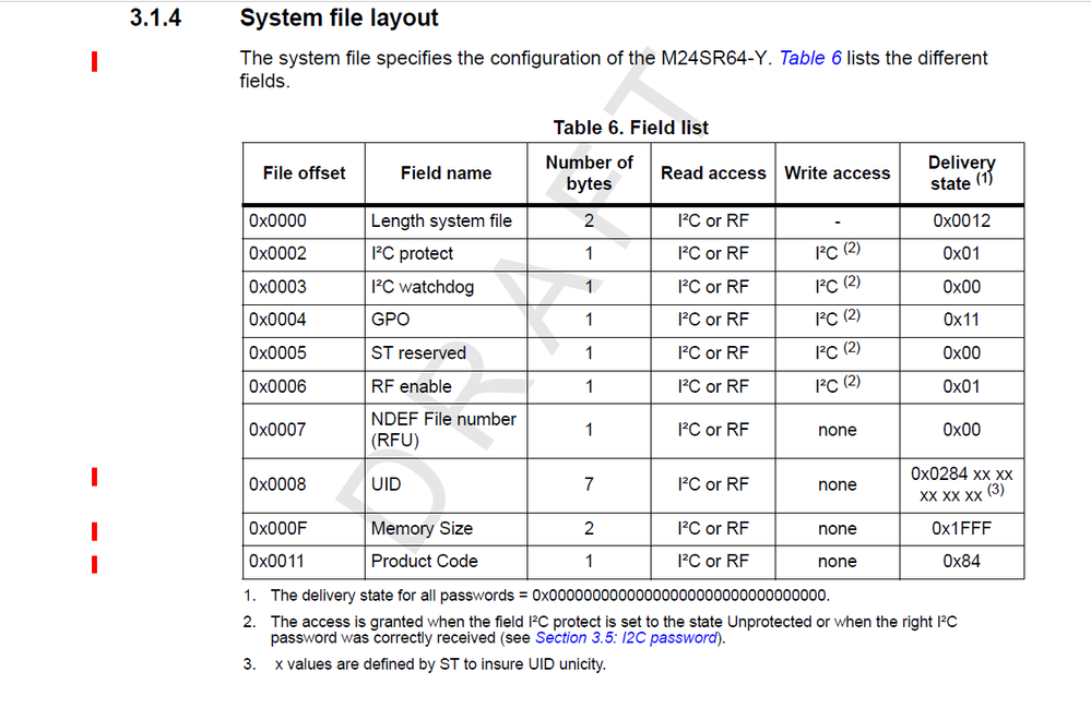

2021-08-10 7:40 AM
hi again Adura,
After verification, GPO mode is only configurable by I2C and not by RF.
By RF, you can only read GPO mode and GPO value, and that"s all.
hope it clarifies.

2021-08-10 7:45 AM
ref to table6 of M24SR datasheet
