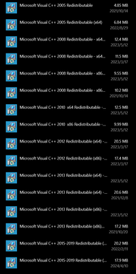

2024-04-23 12:55 AM - edited 2024-04-23 1:52 AM
How about other Microsoft Visual C++, here is my pc install, please check if you miss someone.
Please install Microsoft Visual C++ 2010 version first
