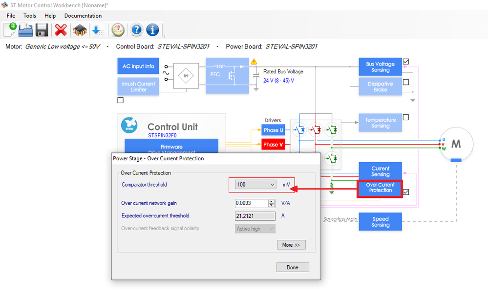

But, I am trying to RUN the motor first using ST Motor control workbench. I did not find where to SET the GPIO's PF6 and PF7 in the GUI.
Please help me on it.

Hello Ritul,
Sorry for the delay in my answer.
The PF6 and PF7 are automatically selected when selecting the threshold in the "Over Current Protection" block.
The workbench should generate the code with a proper configuration for these two GPIOs, according to the threshold selected.
