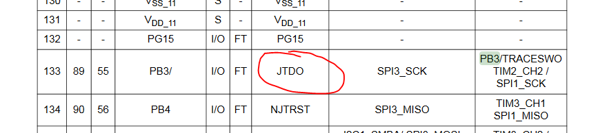

Posted on August 11, 2017 at 13:37
Hello
the default state of PB3  after reset is as JTDO.
So you need to remap it to PB3

Posted on August 11, 2017 at 14:45
Enable the AFIO clock, and then free up the debugger pins
RCC_APB2PeriphClockCmd(RCC_APB2Periph_AFIO, ENABLE);
GPIO_PinRemapConfig(GPIO_Remap_SWJ_Disable, ENABLE);
or
GPIO_PinRemapConfig(GPIO_Remap_SWJ_JTAGDisable, ENABLE);
https://community.st.com/0D70X000006SyA1SAK
The HAL has something similar
__HAL_AFIO_REMAP_SWJ_NOJTAG
