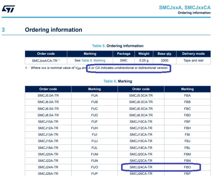

Hi all,I need some help to know what is the reference of this component ? I can read ST e3 G FBo Z205 but it's impossible to find something like that on the net to purchase it. I need 2 of its. I'm in France if you have a resealer which is seeling this?
Is it a kind of Zener diode ? if yes what ios the correct ref to purchase it?

e3 refers to the metal or tinning as I recall
FBO SMCJ24CA-TR https://www.st.com/en/protection-devices/smcj24ca.html
Bidirectional TVS diode

thank you, how do you know that this is this ref SMCJ24CA ?

Cause that's what the datasheet says it is, along with the information that it's the Bidirectional TVS, which can also be observed from the lack of a white bar conferring direction
https://www.st.com/resource/en/datasheet/smcj24ca.pdf
