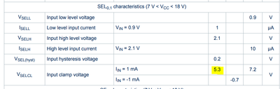

I can't find the max operating voltages of the logic pins. Is it same as Vcc? Thanks.

5V. Above that they're going to start clamping the voltage. See Table 9 in the datasheet.
