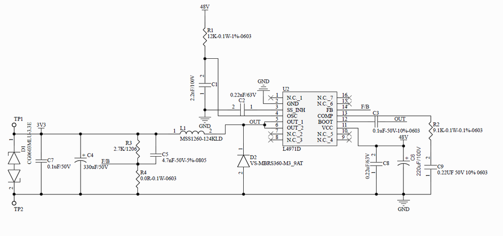

R3 = zero ohm C5, R4 = DNM
2022-05-20 6:39 AM
Welcome, @RMish.2, to the community!
Unfortunately, you got confused when choosing the feedback voltage divider, for which there is a table in the data sheet in figure 4.
For Vout= 3.3V you have to:
However, it should also work if you only remove R4.
Does it answer your question?
Good Luck and regards
