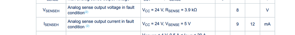

Q:  *Are there 8V in the CS pin under fault conditions?
A: I'd say very likely, based on table 9, voltage clamps at 8 V.

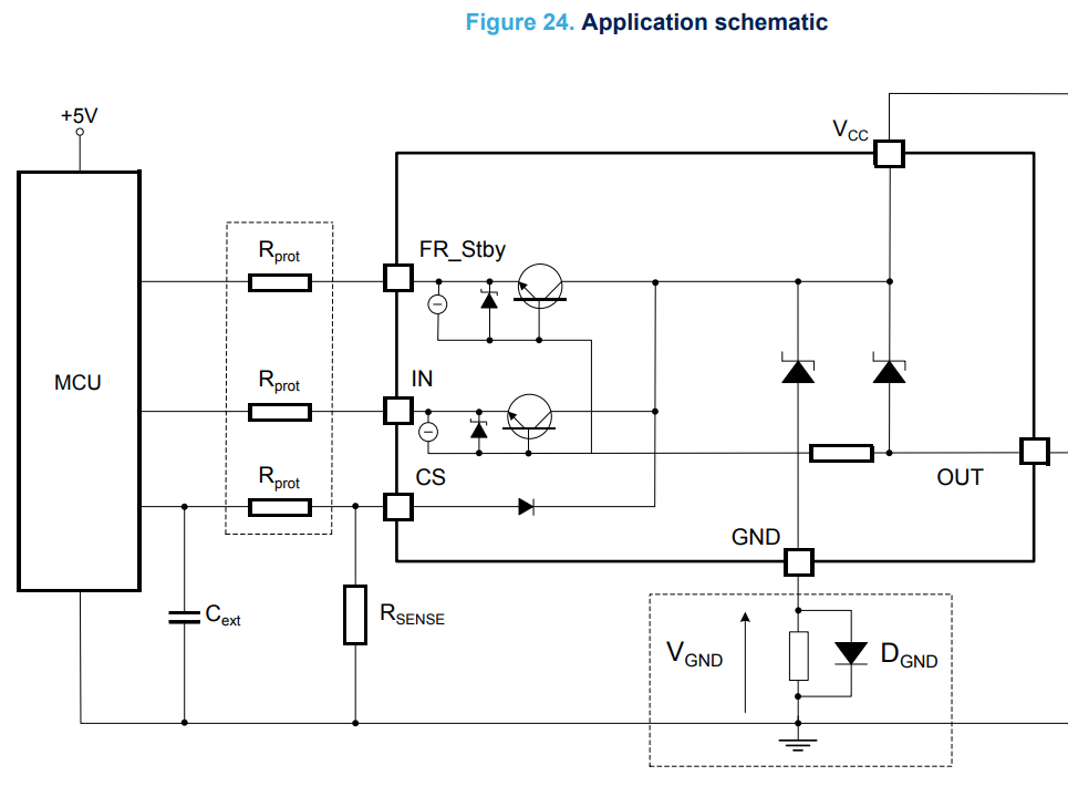

 This dictates next circuits to be implemented with R-prot:
