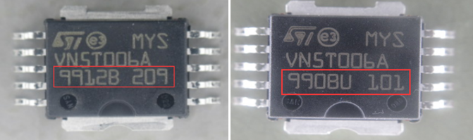

The date codes are to be interpreted as always: YWW, which also applies to the VN5T006ASPTR-E, which has the component marking VN5T006A.
Since VN5T006ASPTR-E was launched in 2012, the examples should be read as:

Dear Peter,
Thank you so much for the reply. I have a follow up question on this.
Kindly confirm if the highlighted in the photo marking code 9912B & 9908U are lot codes.

These codes 9912B and 990BU are no lot codes, but internal codes for production sites.
