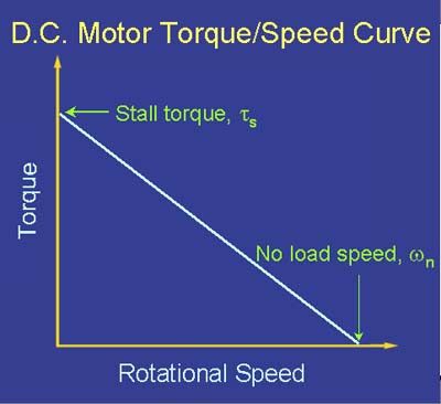

Hi @Cristiana SCARAMEL yes Now i get it. It is important to also state that for the purposes of motor control, the operating point actually shifts across different torque speed characteristic curves. This is true especially if the terminal voltage between two phases is modulated -- and that was what I had in my project. The speed controller modulates the output voltage between two phases of my inverter to get my BLDC motor to set-point speed.
So basically, the torque-speed curve changes as the voltage changes from 0 to DC-link voltage. So, the DC link voltage sets the maximum torque speed curve i.e the maximum achievable speed (no-load speed) and torque(stall torque). Therefore, it explains why regardless of the amount of current I supplied to my system, I just could not get it to a speed higher than the no-load speed set by the DC-link voltage.
Also, there is a more complex but simple relationship between the voltage, current, torque and speed like you said. When driven by a speed controller, especially if the speed controller has an output current saturation limit, sometimes it would not be able to achieve the setpoint speed even though it is less than the no-load speed determined by the DC-link voltage. So increasing the output current saturation limit can make the motor achieve the setpoint speed.
I hope this will be useful for someone in the future so they don't have to pass through the confusion I had to go through.

Hi @BoboyeOkeya
I confirm that your assumptions are correct.
In the end the concept is that each motor has a relationship between voltage, current and specific torque.
Regardless of the range that is able to manage the inverter, you will never exceed the physical limit given by the characteristics of the motor.
Please click on the 'Select as Best' label to close the topic and help other user to find the answer to a similar question.
