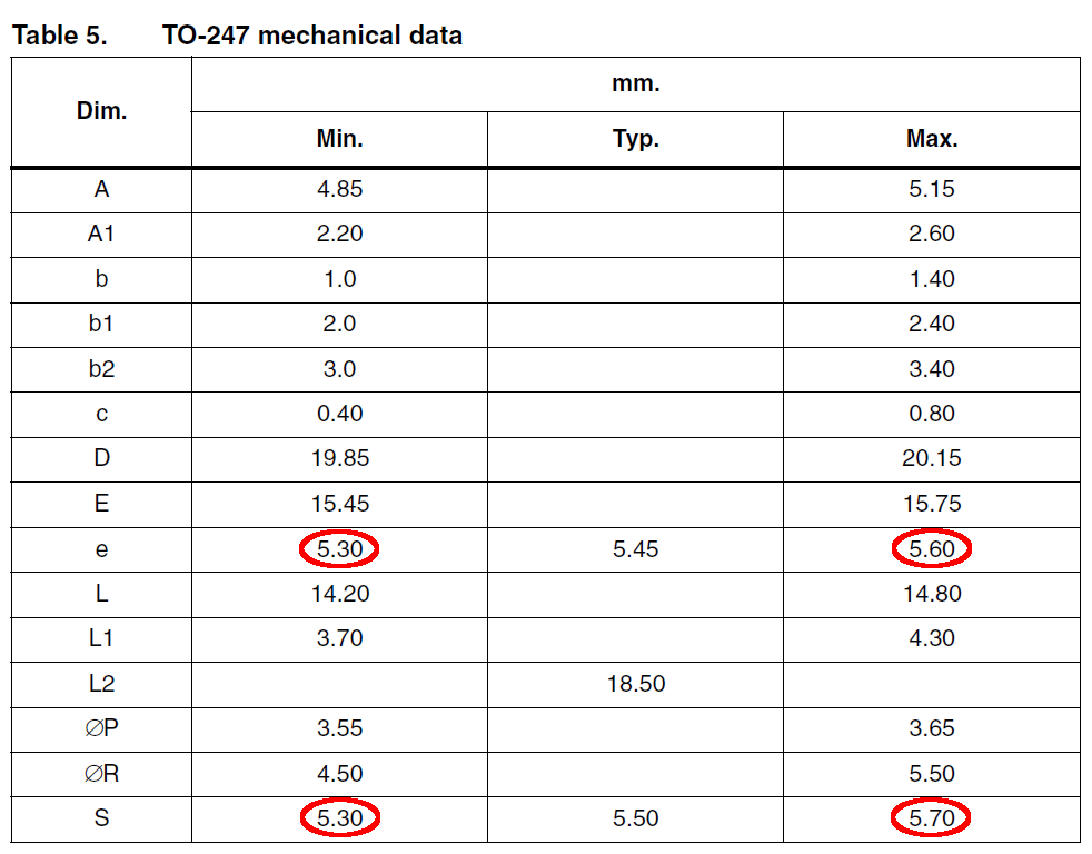

From Rev 7 to Rev 8 only tolerance values for dimensions e and S were added:The supplier is always responsible for the delivered goods; the respective manufacturer will only take action after intervention by this supplier.

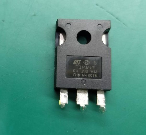

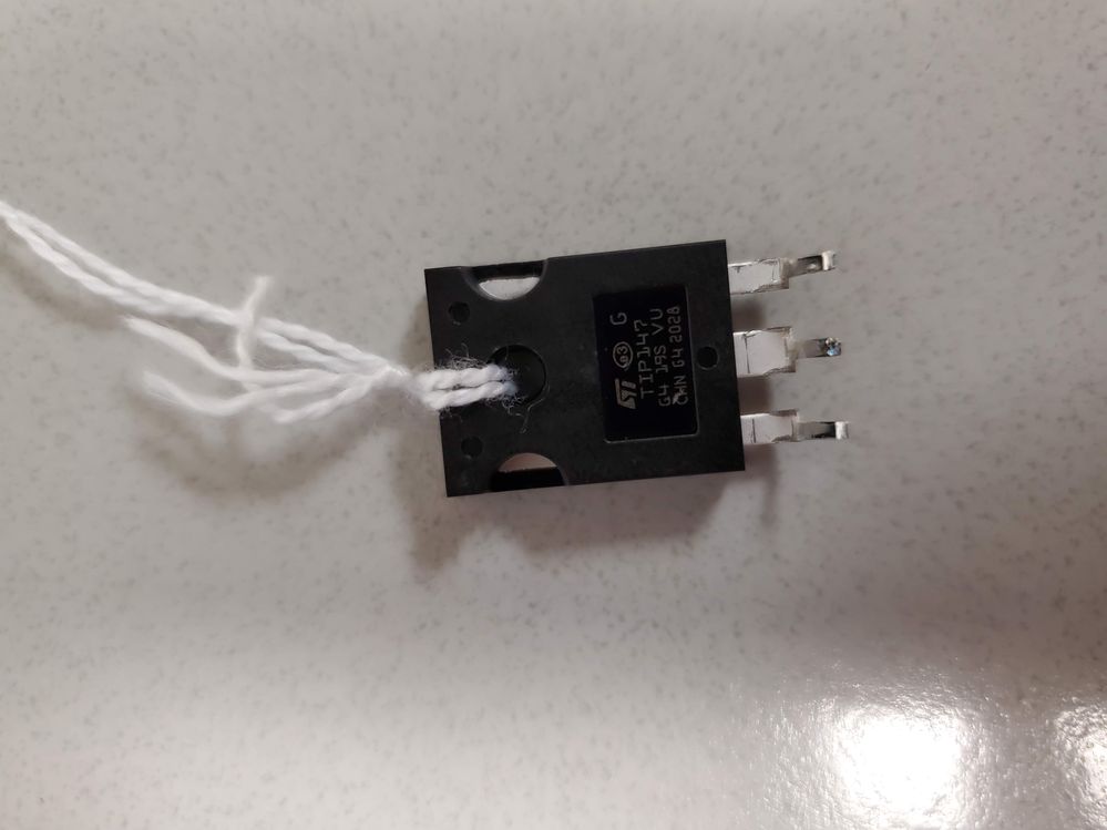

Thanks for your answer, actually we received the Quality complaint on this item from customer, they feedback it can't work normal when input 30V current, it drops to 23V, i share the component picture & video for your reference, what's the problems for it cause, customer is request the failure anylasis....

Well, it seems to me that this has nothing to do with the TIP147, but with your circuit of the board or, for example, the dimensioning or the condition of the coil visible in the video. Anyway, the voltage of the power supply collapses because the set maximum current of 3.1A is reached.
Maybe one can make a statement if you post the circuit and the parameters of the components here.

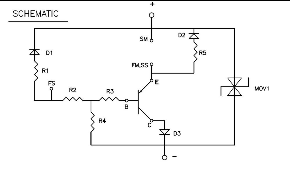

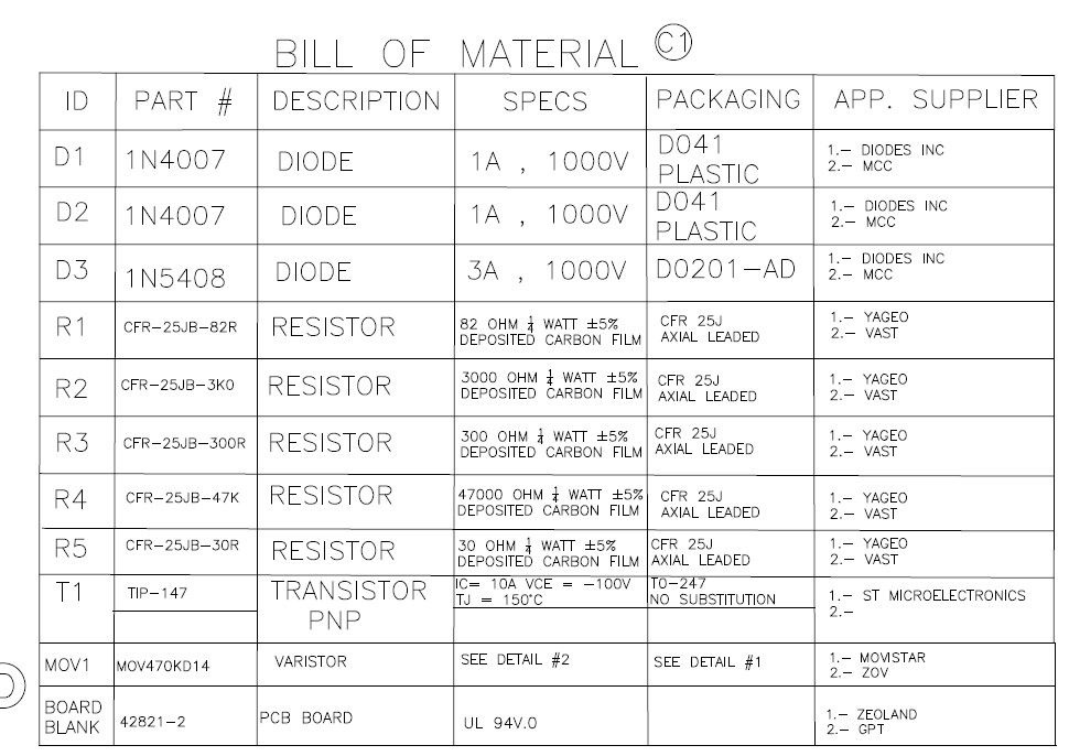

Thanks Peter, i got some information from customer, below are the BOM & SCHEMATIC, is that any help on the case?
2022-08-29 2:12 AM
During the test, only the supply voltage is applied, which then collapses during a video. Since there is obviously no connection at point FS, it is only a question of the current gain of the respective transistor whether the current reaches the critical value of 3.1A here.
For further assessment, we need to know both the expected operation of this module and the parameters of the things connected to FS, FM/SS and SM.

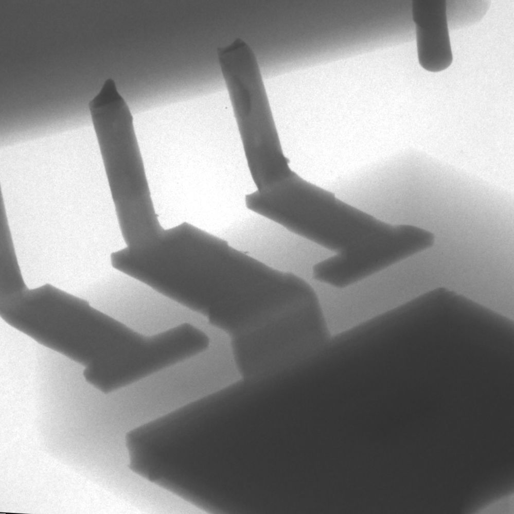

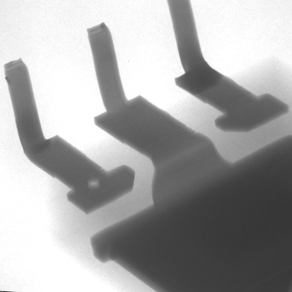

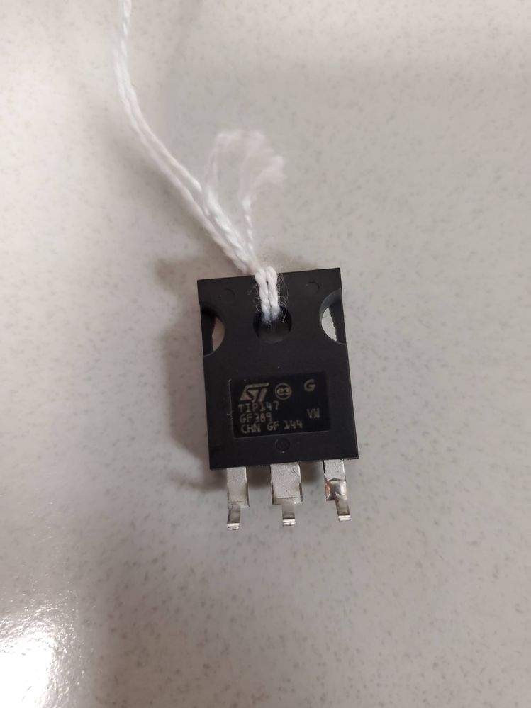

customer make the X-Ray test on the component, lot 2028 and lot 144,
seems this is difference on the pad leg, please see below images,
...Was there an ECN for this change by ST?

The transistor TIP147 withstands a voltage VCBO, VCEO of up to 100V under certain test conditions. The respective behaviour, however, depends primarily on the surrounding circuit, especially with inductive load, spikes or unsuitable circuitry can lead to the destruction of the transistor. STMicroelectronics guarantees the values specified in the data sheet, but the respective user is responsible for compliance with the operating parameters.
As far as the lead frame is concerned, I do not have a PCN that has changed anything in the last few years.
The component with the number 2028 looks very suspicious and you should have the supplier check whether it is original and not a counterfeit. A quality inspection of components must always be initiated by the respective supplier, who knows the official procedure for this.
