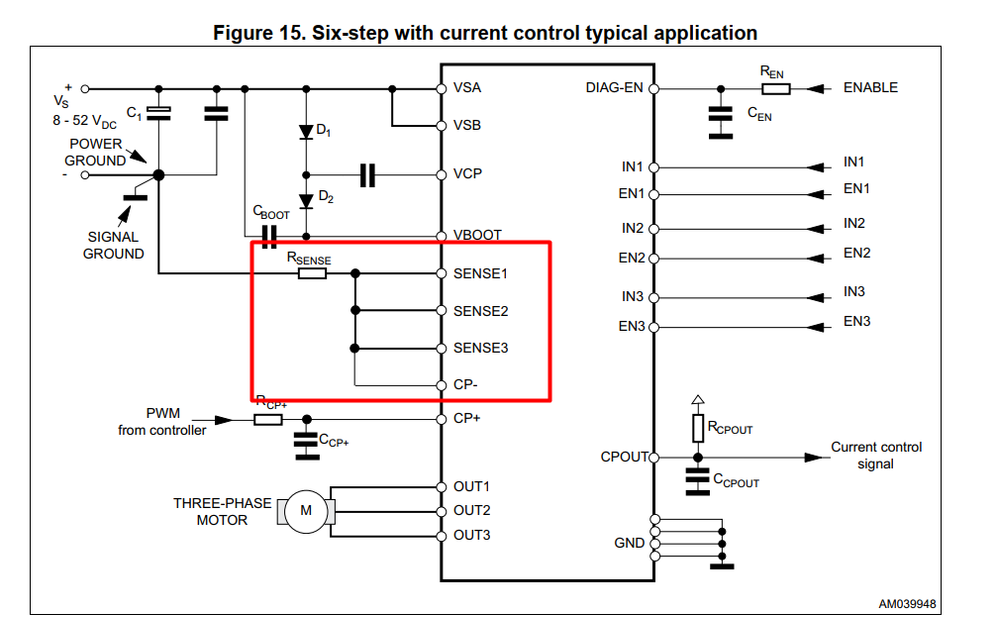

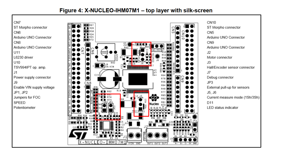

For six step control please check the next jumper settings:
All jumpers you can see on below picture (UM1943):
With above jumper settings, you make configuration for 1 shunt current reading (which is requested for six step motor control). You can find more information on L6230 datasheet.
