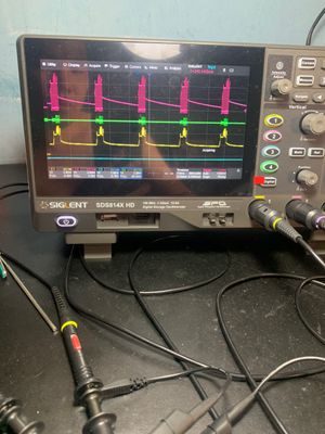

and Below the schematic is the scope that I captured when put the circuit on the wireless charger pad
Red is AC1, green is AC2, yellow is VRECT, and blue is VOUT
I see the VOUT is still 0V and the AC1, AC2, and VRECT waveforms look like wrong.

From your waveform, Vrect send some ASK packet and then drop power, seems TX CEP timeout.

Below is the scope after I modify the 2 capacitors COMA from 22nF to 47nF and 2 capacitors COMB from 10nF to 22nF, it still does not work.
What should I do next? Should I continue to increase the capacitor value?

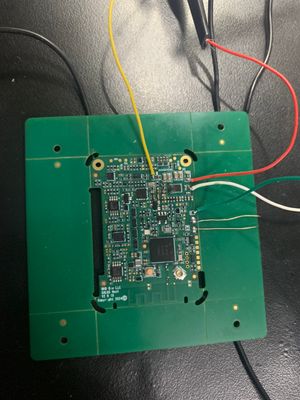

Below is my custom PCB,
How can I use these firmware files?
Does the MCU need to communicate with the STWLC38 chip to enable the chip?
I think when placing the circuit in the TX charger, it will need to power up first, then the MCU can communicate and configure the STWLC38 chip. According to the current status, the STWLC38 chip has not been powered-up yet, so how can we use firmware to communicate with the STWLC38 chip?
