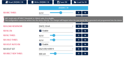

First, ARC mode is said to increase the radius of X and Y axis of wireless charging by up to 50%.
1. why is it CFG register, is the mode always active?
2.the setting value is steps of 10mV and I wonder what is the relationship between this and ARC mode?

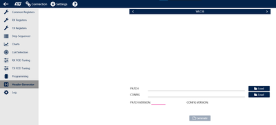

3.GUI related question, how can I take memh files of CFG files and patch files and convert them to hex code and update them to firmware?
I have implemented the firmware update, but I want to update it with data from files created in the GUI.

Q2.the setting value is steps of 10mV and I wonder what is the relationship between this and ARC mode?
A2:When rx vrect > 6V it will disable arc mode
Q3.GUI related question, how can I take memh files of CFG files and patch files and convert them to hex code and update them to firmware?
A3: use gui head generate or check AN document.
