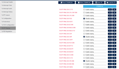

I have check default cfg,
when TX detect three occasions.
It will disable re-ping, so TX will not ping. It need MCU/AP to clear this state and set command to "TX Start".

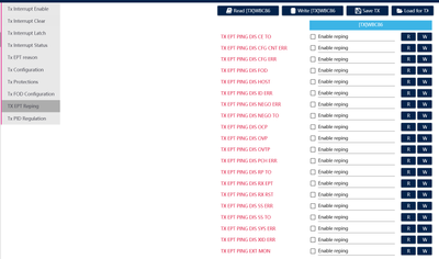

I have update new cfg and disable ept reason, please use this link cfg file
After update this cfg file, GUI show all TX EPT Reping is disable.

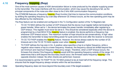

Based on manual
It maybe tx stuck in fhop feature, change frequency and stay in power-stage mode.
2024-04-23 1:35 AM
if i understand correctly Fhop is enabled by default.
so you reccomend to disable Fhop feature?
