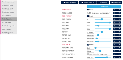

Do you mean, STWBC86 is work on ping phase, even RX is on, it can not charging devices?
It will be nice if you can share below GUI picture to me to get more information.

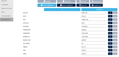

i could recreate it within a day.

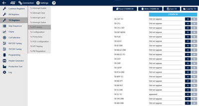

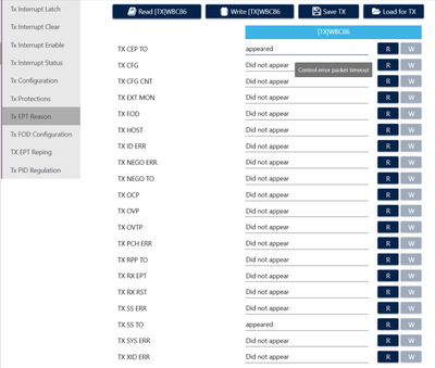

Please find the screenshot below:
as well see a shot of the mode monitor:
RX and TX powers values are misleading in correlation to ICUR.
I also looked at the TX Interrupt latches and did find that if i write to "Did not occur" further testing does not alter them wich is different in a Controller not in that "error" state.

HI
From your picture, TX get cep timeout, which mean do not get RX Control error packet, So TX will cut off power.
Seems TX/RX communication is bad, What is RX output voltage? Do you use STWLC38-EVK for RX?
How about you adjust TX input voltage, set higher like 6V and try it.
Also you can use GUI and set "TX CE TO MAX" to 10, make cep timeout less to happened.

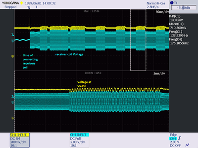

i checked with a scope. the TX is still on (even if RX is removed). This will carry on forever until i reset the controller. Also i guess the CEP is there because of the removal of the RX on the previous charging cycle.
I use an IPhone for testing as well as Ti bq51050b. RX rectifier voltage is perfectly fine (5V) as well i checked the voltage at the VS pin of the TX. (DC-Level and AC component)

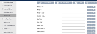

But your TX have some problem. So you need to modify set "TX CE TO MAX" to 0, make it easy to detect RX removed.
Please give me abnormal TX "TX EPT reason" GUI screenshort.

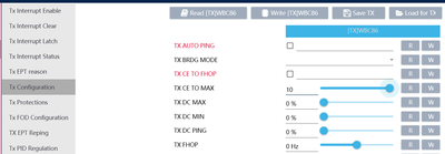

So i suggest you set this value to 0 and test again.
2024-04-15 5:49 AM
i will try and give you feedback asap.
the WPSTUDIO doesn't let me set 0 so i will try with the minimum which is 1.
