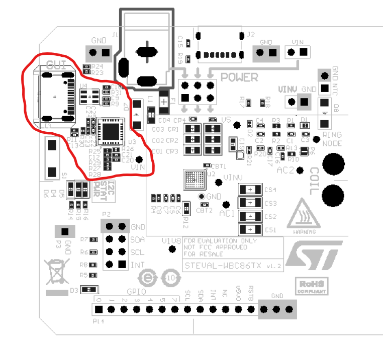

Yes, it turns out that what we want is to replicate the STEVAL-WBC86TX and just remove some things from it, but we see that it comes with a configuration using the FT260Q chip that would be the U3 (in the image), which they use for I2C Communication, converting it to USB- C and from there to the PC. I would like to know if with this same STEVAL chip we can upload the initial configuration of the new board.
2024-10-11 4:44 PM
yes
it is same with STEVAL-USBI2CFT Dongle chip
