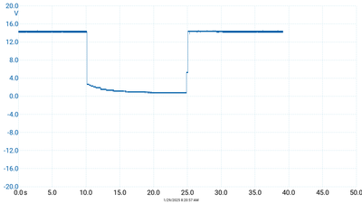

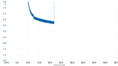

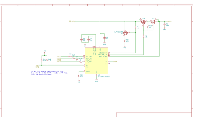

The captures have been made on SINK side, haven't they ?
If this is the case, the discharge time can not be impacted by the STUSB4710 and you are right, this is probably linked to the discharge circuit of the Sink device (the threshold is usually around 0.6V).

Here are a couple of screenshots of the behavior. A disconnect of the USB-C PD sink followed by an immediate reattach takes >10s to re-enable. This is the measurement of Vbus over time.
From the datasheet, I expected the default behavior to be around 840ms. This is on a custom design though the schematic was lifted from STEVAL ISC004V1. I assume this is more likely the sink device not properly discharging its own capacitance which prevents the STUSB from re-enabling?
