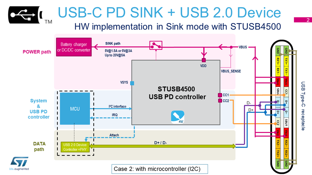

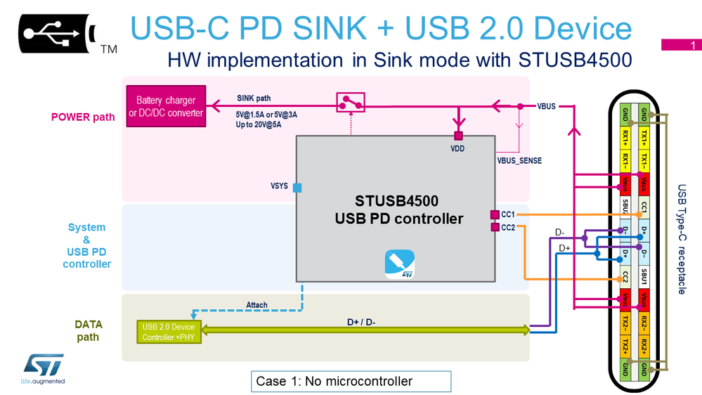

Yes, you can use the ATTACH pin on STUSB4500, to know if the USB-C cable is attached or not.
The ATTACH pin is open-drain, so you need to add an external pull-up resistor.
Note that the ATTACH pin is used on STUSB4500 evaluation board (STEVAL-ISC005V1), when the board is mounted on STM32 Nucleo Board.
See some examples on the pictures below.
