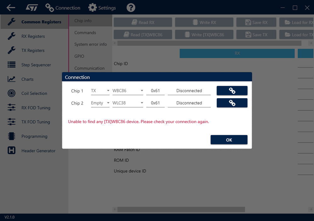

"Unable to find any [TX]WBC86 device. Please check your connection again."

I tested the GUI on another Windows 11 laptop, and I still have the same issue with version 2.1.0. It cannot connect to the board and show the error message.
Did ST try the STSW-WPSTUDIO software on a Windows 11 PC ? Or does the GUI only work on Windows 10 ?
Connection ERROR again

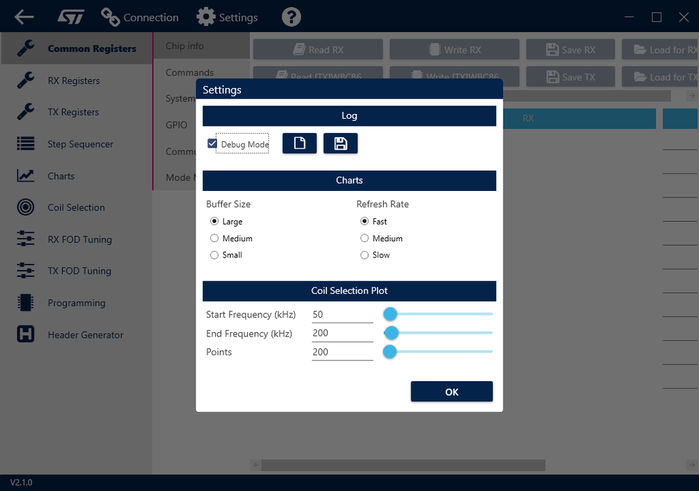

I saw in the SETTINGS menu, there is a "Debug Mode" that we can enable.
But even enabled, I still don't see any LOG menu appearing on the main interface.
How did you enable the LOG menu ?
Debug mode enabled doesn't change anything

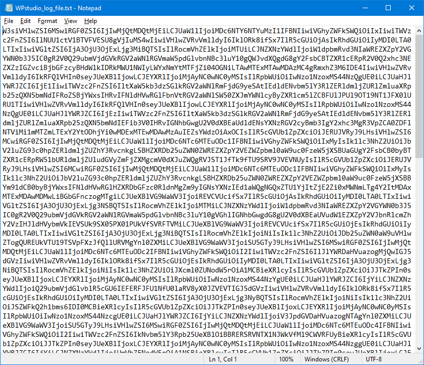

I tried to click the save button: "save current log to text file". But the log file recorded is meaningless because it is just binary data !!
How can I find out by myself what is the software issue if everything is kept in binary format by ST ??
log file is unreadable

Please install “Microsoft Visual C++ 2015 Redistributable” package.
2024-04-23 3:39 AM
We have confirmed this version GUI is dependent on “Microsoft Visual C++ 2010 X86 Redistributable Package” .
Please download this version.
2024-04-23 6:16 AM
A 14 year old Service Patch, why didn't I think of that?
2024-04-23 8:24 AM
Hi
This is due to FT260 dongle dll file need this Microsoft Visual C++ 2010 driver.
