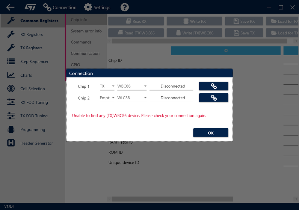

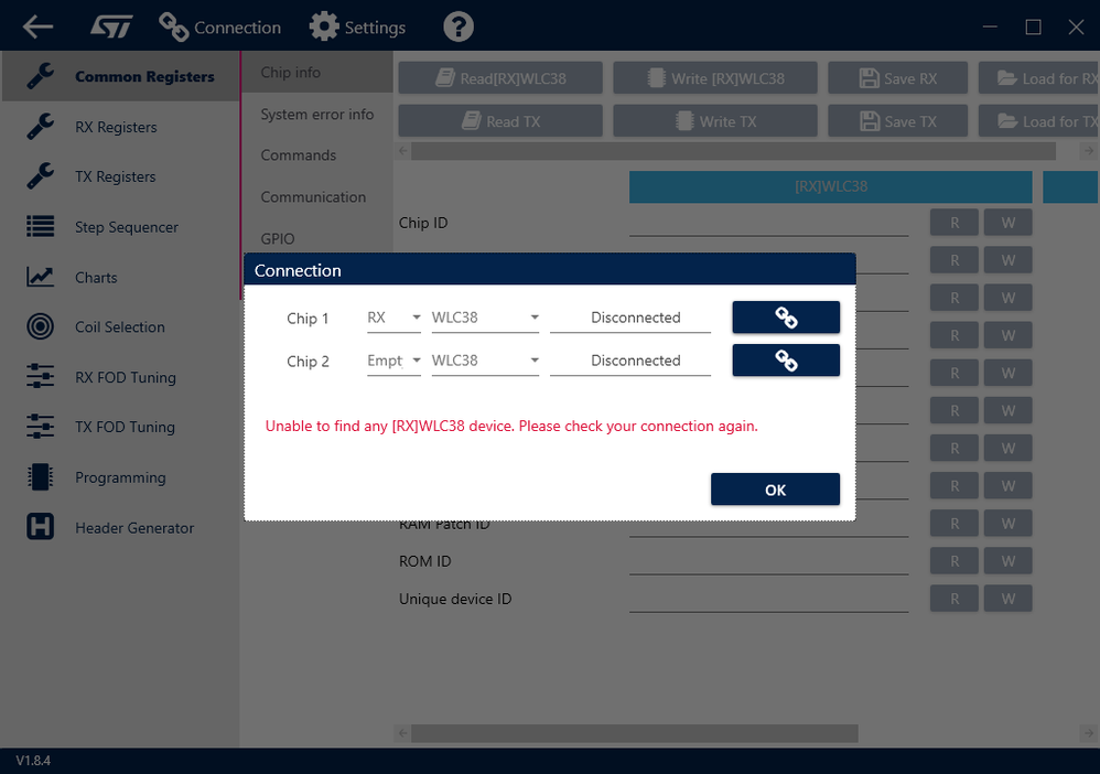

I use STSW-WPSTUDIO V1.8.4 software to try to connect to the board from my PC and get access to the register setting. But every time I click on the Connect button, there is the same error message appearing:
"Unable to find any [RX]WLC38 device. Please check your connection again."
The issue is the same with both boards.
But it seems the boards are working, because when I place STWLC38 on top of STWBC86, the boards are charging, because I can see the red LED on the receiver board, and Vout is 5V.
So the main issue is the GUI.
I cannot use the ST GUI to connect to any of the ST boards that I paid $200 for ! (with shipping + fee cost)
My computer is Windows 11. And the board is properly connected through a USB-A to USB-C cable.
I followed the steps from the user manual. The 2nd USB-C connector of STWBC86 is connected to 100W USB-C adapter. So the boards are powered on, because I can see the LED turned on. I tried with other USB cables, and it is still the same issue.
And I didn't install any USB driver on Windows because I didn't see mentioned anywhere the requirement to install a driver to use this board.
Do I need to install a USB driver ?
"Unable to find any [TX]WBC86 device. Please check your connection again."
STWBC86 GUI connection issue
STWLC38 GUI connection issue

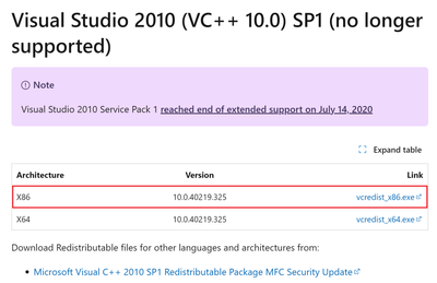

2024-04-23 3:39 AM
We have confirmed this version GUI is dependent on “Microsoft Visual C++ 2010 X86 Redistributable Package” .
Please download this version.

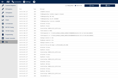

Also can you share your LOG information to me?

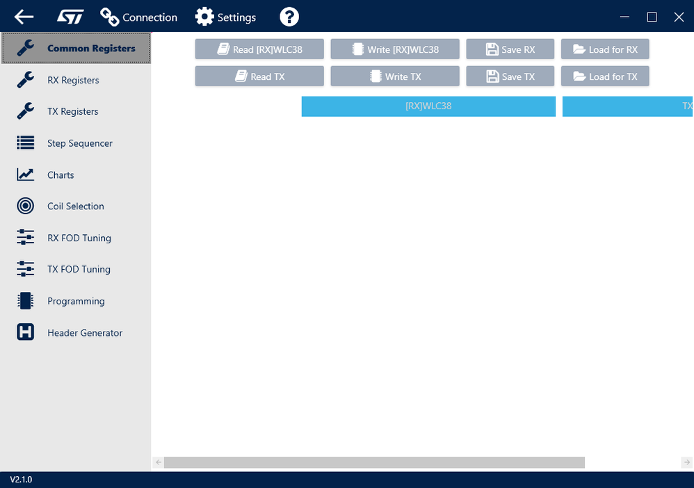

2024-04-16 12:32 AM - edited 2024-04-16 12:37 AM
Hello Sir,
I tested WPSTUDIO version 2.1.0, but there is no LOG available in this version !!
So how are we supposed to see the full error messages ?
STSW-WPSTUDIO_v2.1.0 still buggy
And I don't see any release notes for the software you provided.
So which bugs are fixed in v2.1.0 ? Is it supposed to fix the USB connection issue ?

I have test in several computer and this tool can be used and log can be seen.
Can you test in other computer .
