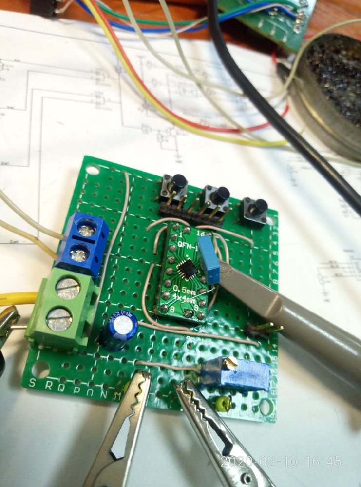

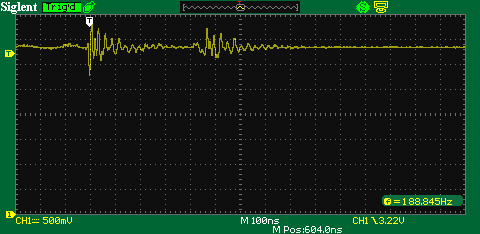

I can’t read the FAULT state when the specified load limit is exceeded. the oscilloscope shows that the signal does not drop to a logical zero.
my board

what is the value of pull up resistor connected on EN/FAULT pin?
Moreover, for a better support please share the board schematic.

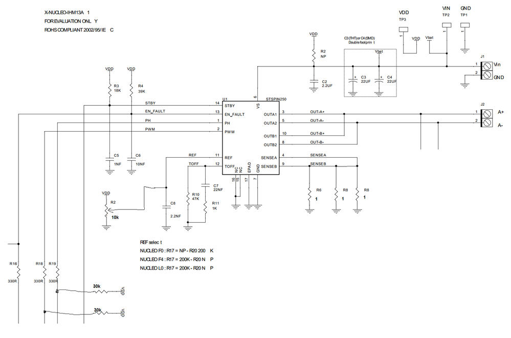

2020-02-13 4:19 AM
set different values
R4 - 18k, 36k, 100k
C6 - 10nF, 47nF, 2.2uF

Could you provide some oscilloscope waveforms when the overcurrent occurs showing:
