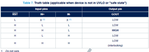

In
datasheet is funny table , input -> output state, the most important thing for a driver - but wrong:
btw : 1. Do not care. -- is perfect here.
2025-01-29 6:34 AM
Hello @AScha.3,
Thanks for reporting, we are working on the new revision of the datasheet.
In the meantime, I attach the correct version of the table:
