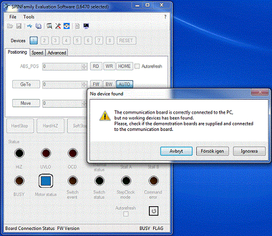

Hi, I am trying to use the PCC009V2 and an EVAL6470H board through the spinFamily Evaluation Software. but i get the following error:
2014-03-18 6:06 AM
I tried to just ignore the error and it seems to work!
2014-03-24 7:30 AM
the warning is generated because the EVAL6470H is not supplied. When you click on connect the PCC009V2 checks how many evaluation boards are connected and if no boards are found the GUI shows you this warning. Regards EnricoWe’re moving the ST Community to a new platform to give you a better and more reliable community experience.
