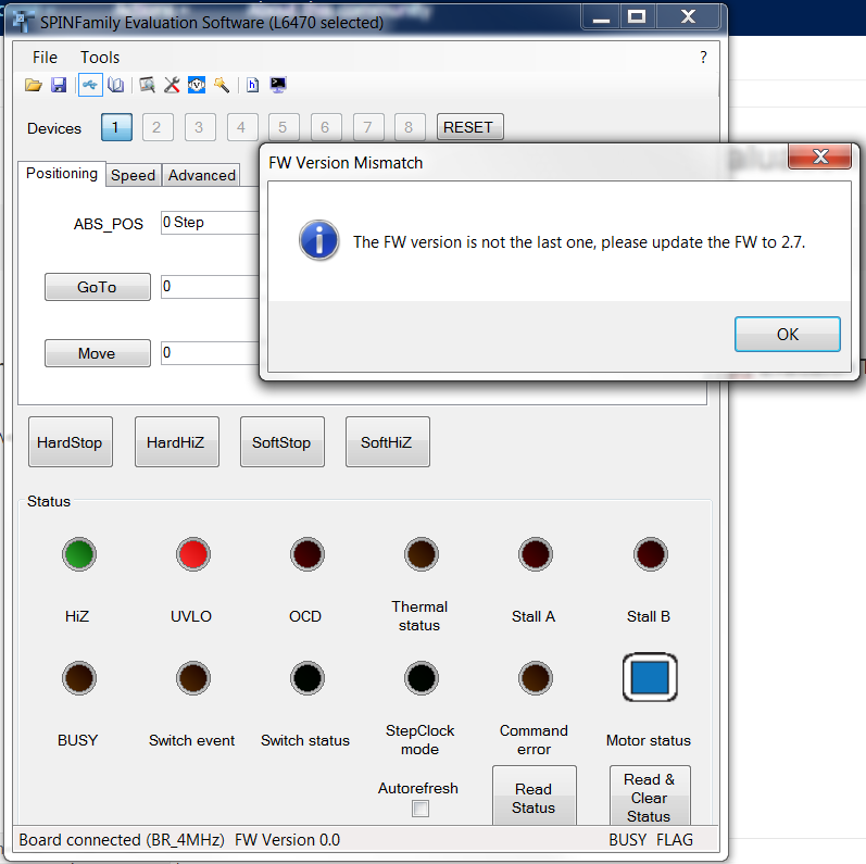

I am trying to use the STEVAL-PCC009V2 & EVAL6470H boards using the SPIN
Family Evaluation Tool (Version 3.2)
However when I try to connect to the board I get the following error:
I have managed to locate the below hex file at the following location:
C:\Program Files (x86)\STMicroelectronics\SPINFamily Evaluation Tool 3.2\Firmware
I have tried to download the hex file below onto the board using Keil uVision but I am getting the following error in the Build Output.
It should be noted that I was able get older versions of the SPINFamily Evaluation Tool to work.
If anyone has any solutions to this problem or has a link to Version 3 of the Evaluation Tool I would greatly appreciate it.

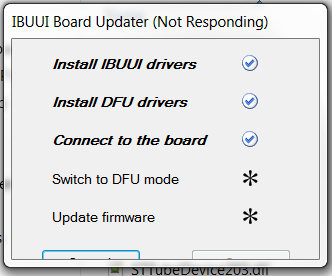

2017-04-07 8:46 AM
Hi Enrico,
Thank you very much for your response!
I tried to update the board using the ?IBUUI Updater? tool and I got through the first three steps as shown below. However, the program crashes when it gets to the next stage (Switch to DFU mode) and it doesn?t go any further in updating the board.
IBUUI Board Updater - Stuck at 'Switch to DFU mode'

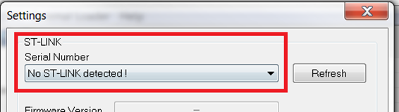

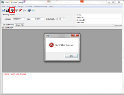

I then tried to update the code through the ST-LINK Utility. However I was unable to connect to the board. I got the errors shown below.
STM32 ST-LINK ? Connect to the target
STM32 ST-LINK ? Settings
Updating the firmware through Keil µVision has not corrupted the flash on the STEVAL board because I can still download the older version of the hex file and use the older version of the SPINFamily Evaluation Tool.
2017-04-07 9:32 AM
Hi Ernest,
The PCC009V2 is not a STLINK itself! You should connect a STLINK programmer to the 20 poles connector of the board. You can also use a Nucleo board as programmer, but in this case you have to wire the SWD lines by yourself.

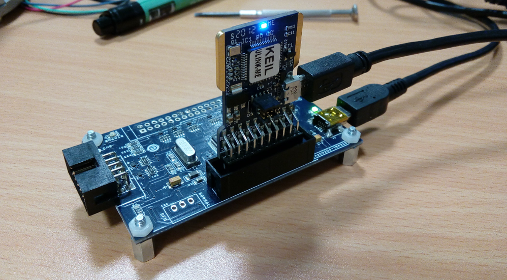

2017-04-07 10:10 AM
Hi Enrico,
This is the current hardware setup I have. I have connected the 20 pin Keil U-Link ME connector to the 20 pole connector (J3) and a USB mini cable to connector J4 on the STEVAL board. What changes do I need to make for your solution above?
Thanks for the User Guide link as well. I was actually following that method anyway for downloading the Hex File through Keil uVision.
2017-04-10 2:25 AM
It looks of from the hardware point of view.

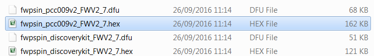

Please, try the attached S19/HEX instead. They are directly extracted from the DFU file.
________________ Attachments : fwpsin_pcc009v2_FWV2_7_00.hex.zip : https://st--c.eu10.content.force.com/sfc/dist/version/download/?oid=00Db0000000YtG6&ids=0680X000006HyWw&d=%2Fa%2F0X0000000bBV%2Ffd.Z6AeTN9aTWYJ6cZQ9.IJCWvgVc0SdMR3qbJ5iHFI&asPdf=falsefwpsin_pcc009v2_FWV2_7_00.s19.zip : https://st--c.eu10.content.force.com/sfc/dist/version/download/?oid=00Db0000000YtG6&ids=0680X000006Hyic&d=%2Fa%2F0X0000000bBS%2FvzB.E74axSZrsyb5863SMv2198EYKdR2QsCS7pc5wds&asPdf=false2017-04-10 4:30 AM
Hi Enrico,
I tried the updated hex file which you sent to me this morning and the good news is that it worked perfectly when I downloaded it through Keil uVision. Its a great start to the week.
Thanks very much for the help!
