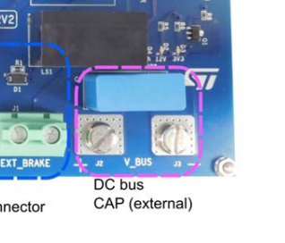

I never tested it but, I think, that if you want to supply a DC voltage to the board is possible to use the same connectors where you mount the external DC Capacitors respecting the polarity.
See UM2645 for some details on the board.
