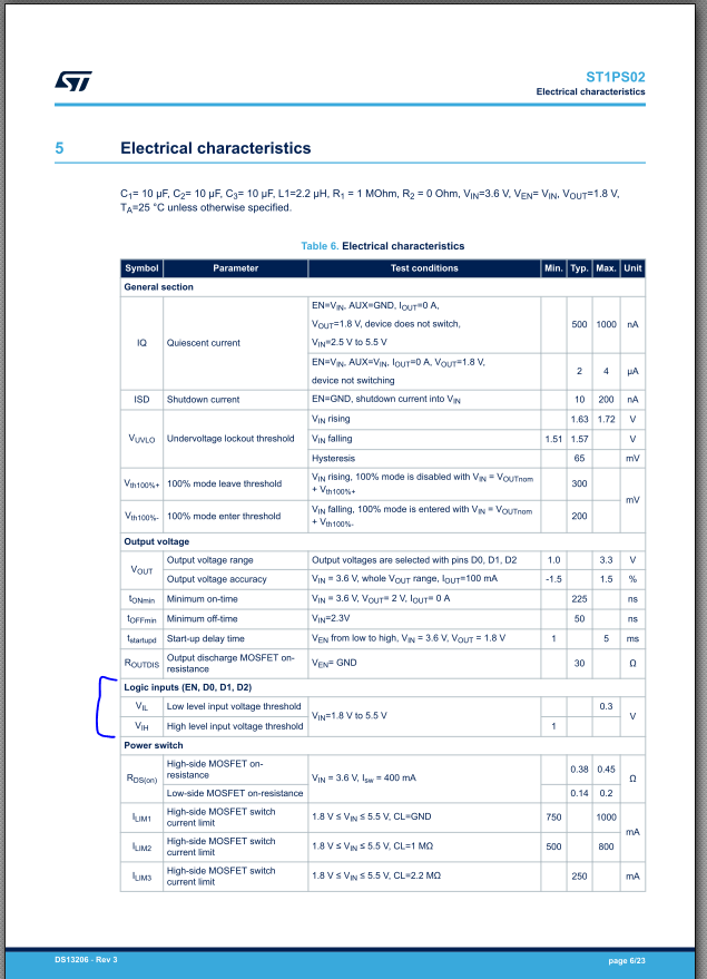

2021-03-04 8:20 AM
Can anyone say what the leakage currents on the ST1PS02BQTR logic inputs are? Usefully I can see the voltage levels, but leakage current into the pins is not specified from what I can tell.
