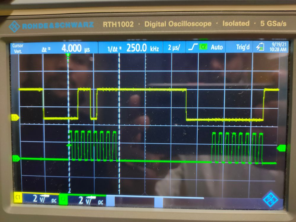

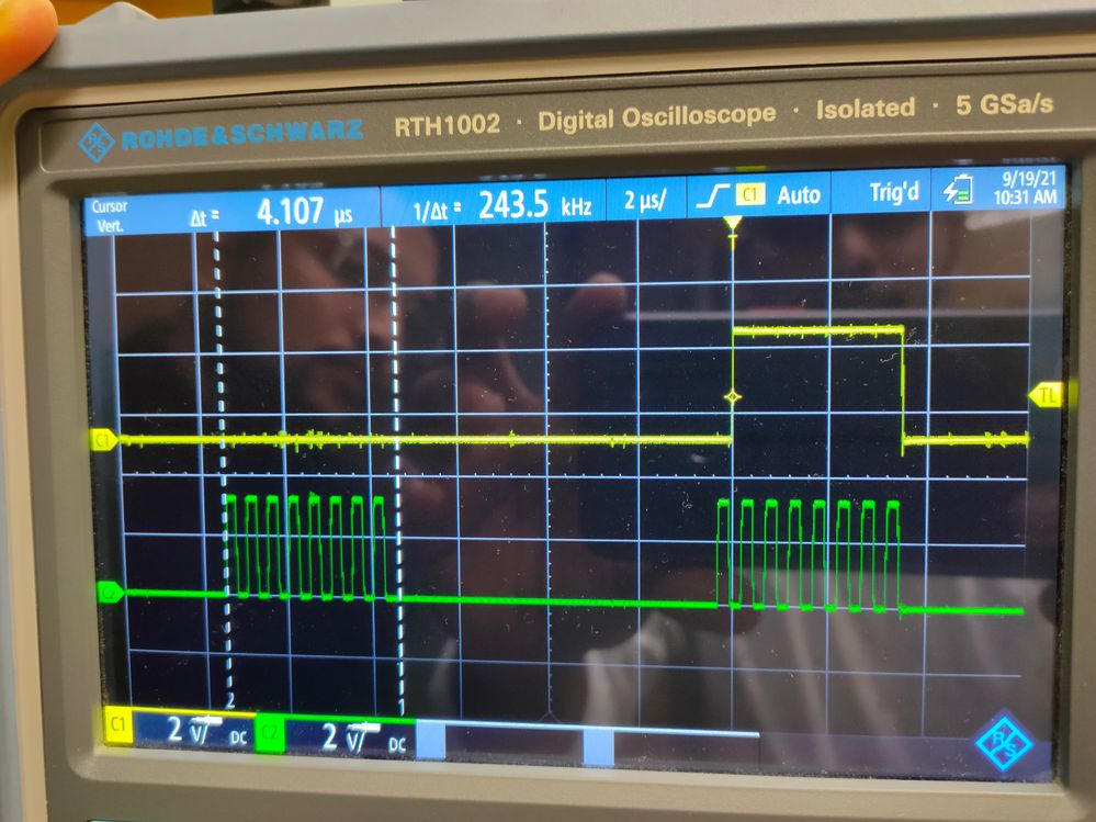

Hello @Cristiana SCARAMEL
As suggested by you we tried to getStatus with CK signal (green trace) with polarity CPOL=1 and we are not getting anything (like it is giving always 0 for all the commands)
But when i change the polarity back to CPOL = 0 we are getting some garbage value.
I am not understanding this peculiar behavior of the drive and my work is getting struck in between.

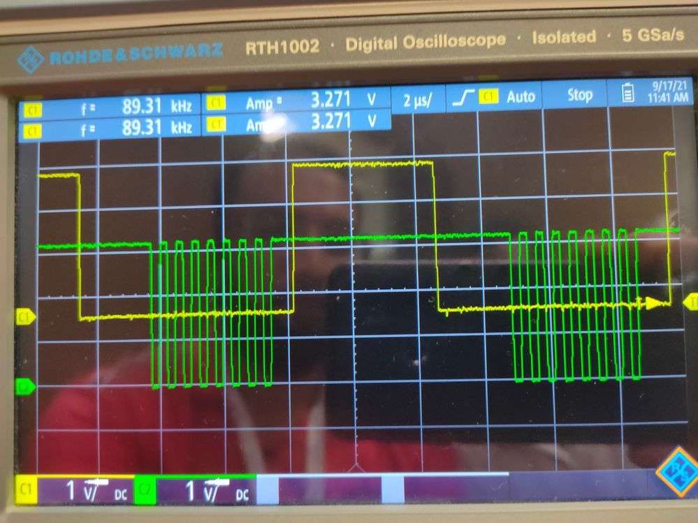

Attaching the timing diagrams please do check and revert back as soon as possible

Hi @Community member,
from your pictures the L6474 is behaving properly.
If you do not configure the proper clock polarity and phase the communication fails.
You must set CPOL = 1 as above mentioned and CPHA = 1 (the IC updates the out on the falling edge and samples on the rising edge).
