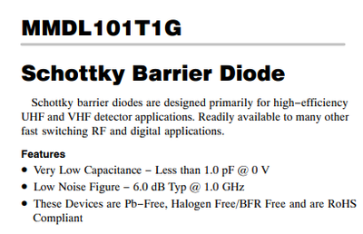

This is a rf diode:
or many others, like :
https://www.mouser.de/ProductDetail/onsemi/MMDL101T1G?qs=P4IOph%252Bbot9kQ4drEZyhAg%3D%3D
here a real fast one, expensive also:
https://www.mouser.de/ProductDetail/MACOM/MSS39-152-H20?qs=%252B6g0mu59x7Ked%252By5qPRwHw%3D%3D
But to get to 5GHz - is not easy.
