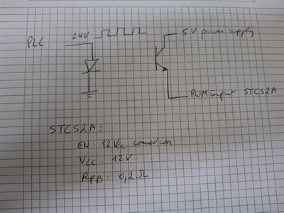

I think you understood the situation correctly but herewith a small sketch to clarify:
I checked the polarity of the STSC2A, which should be correct. It could be that it is defective, however it still able to light up the LEDs, only that draws too high current which leads to blowing of the protective fuse (1A). Any suggestions on how I can check if the STSC2A is indeed defective or not?

As already mentioned, PWM and EN are pure inputs and should not have any significant input current. You could approach the problem and measure the current to the PWM pin, possibly again with a brand-new device:
What does the connection from 5V supply to 12V supply look like?

The 5V and 12V are two separate 230VAC to DC power supplies.
