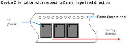

POWERSTEP01TR are come in Reel packaging, I need to know the carrier tape dimension. What is the feeding direction and pitch dimension?

Hi @TBoon.1​ welcome in ST community.
The POWERSTEP01TR code correspond to Tape And Reel packing. In the future if you prefer tray solution you have to use the POWERSTEP01 code.
Here the info about tape & reel packing:
  • carrier tape dimension: 11.4x11.4x1.47mm
  • pitch dimension: 16mm
  • feeding direction: refer to below picture
