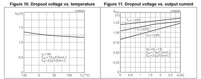

> Input : 5V --> Output : 4V @3A
Anyway not possible...see dropout of LD..: about 1.25 V
2025-10-30 5:33 AM
As @AScha.3 noted, you cannot use the LD1085D2M-R for your specification because it is a so-called quasi LDO. That is why it is not listed on our website under LDO, but under Standard voltage regulators. Although quasi LDOs achieve better dropout voltages than classic linear regulators, they were later replaced by true LDOs with dropout voltages significantly below 1V.
Instead of the LD1085, you can consider the LD29300, which remains below 400mV at 3A and can therefore easily regulate the specified output voltage of 4V.
