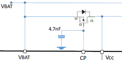

To solve that problem I want to analyse the generator voltage (Pin VCC) and shortcut the H-bridge in case the generated voltage exceeds a limit.
This provides that the motor generated voltage passes the reverse battery protection transistor, so that it can supply the other parts of the circuit (microcontroller, etc).

If supply voltage comes from the motor side (Pin VCC) instead of battery side (Pin Vbatt), will the reverse battery protection transistor conduct so that voltage can pass from VCC pin to Vbatt pin?

Regarding your question, if you have connected the external MOSFET for reverse battery protection as suggested in our datasheet, in the event of a battery disconnection, the MOSFET will turn off and prevent the current from Vcc from passing through and reaching Vbatt.

We want to use the motor generated voltage to supply our microcontroller, in order to brake the motor (pulling output A and B to ground) in case the voltage exceeds 30 V. This is the only way I know to prevent damage by motor generated high voltage.
Q1: If we bypass the reverse protection MOSFET with a resitsor in case of overvoltage, Vbat would be slightly lower than Vcc. Would VNHD7008AY still work as expected?
Q2: Can we just omit the reverse voltage protection and leave pin CP floating?
