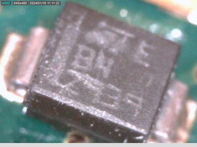

hi Peter, have looked a lot around but i couldn't found what stand for marking B4.
could you please help me?

This is the obsolete fast recovery rectifier SMBY01 in package SMB, which can be replaced by the (faster) alternative STTH1R04U .
Hope that helps?

Welcome @_mik81, to the community!
Can you please upload a photo so that the marking can be recognised?

hi Peter,
ST E
B4
Z939
Hope that helps?
