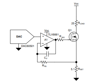

Depends on a led, some have Vf = 1.8, some 3.5V. So, 15x3.5 = 52.5V in linear mode. Also current, 20 mA or more?
For low current low voltage OPA may be an option, or OPA buffered by transistor for high CV

Thanks.
This is what I would like to clarify: so there is no LED driver that matches my custom requirements (i.e. an integrated solution that encompasses the DCDC converter and LED control elements - ON/OFF and current) and the only solution is what you suggest + boost converter.
P.S. For Vf indeed, it's about 3.3V, current - about 20 mA
