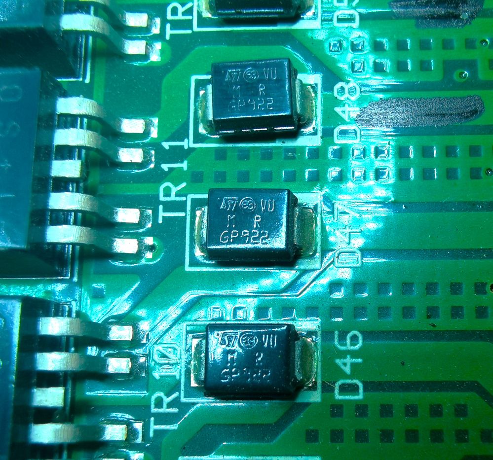

From what I can read on this diode it is from ST for sure, and it says VU beside the logo, the next line is M R, and the last line is GP922.
Any help would be appreciated.IMG_20240703_171230[1].jpgIMG_20240703_172423[1].jpg

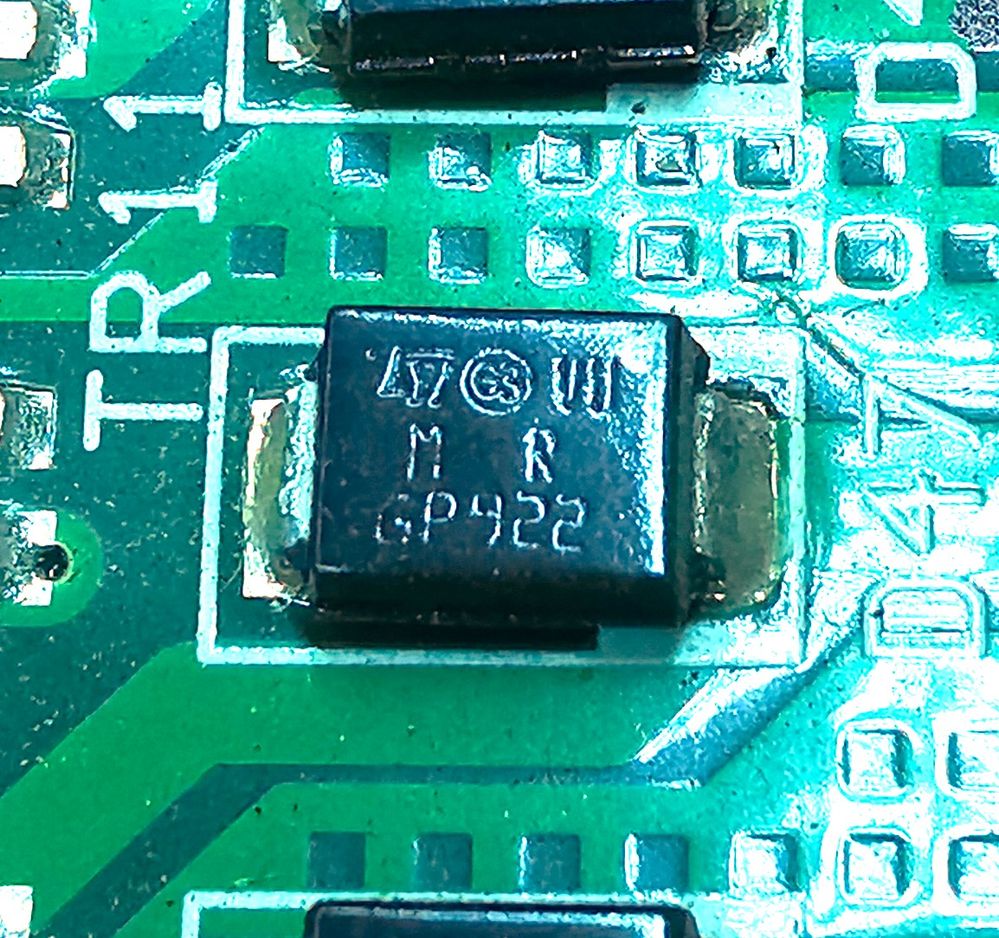

Peter BENSCH
Thank you for the legible photo!
The marking MR stands for the SM6T30CA, a bidirectional 600W, 25.6V TVS in SMB package.
Hope that helps?
Good luck!
/Peter

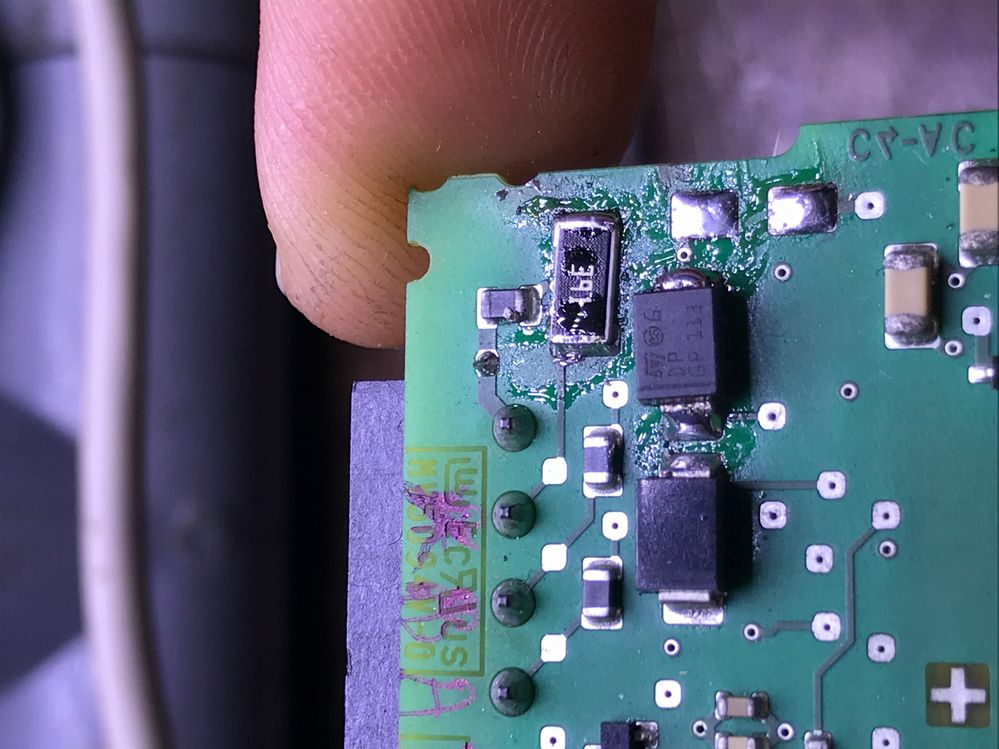

Hi, I have diode with logo ST with code GP 113
Which's diode ?
Perhaps provide a picture in context. Have it be large, clear and in focus..
GP113 is a production location / date code, it is not product ID marking.
The product ID is typically a two or three letter code. Usually alpha.
Agnortan83
Associate II
DP -> SM6T10A
https://www.st.com/resource/en/datasheet/sm6t100a.pdf#page=10
Looks like it's already been replaced, the original part is the one on the left, is the marking on that legible?
Agnortan83
Associate II
Yes, it's 6V8A 18A

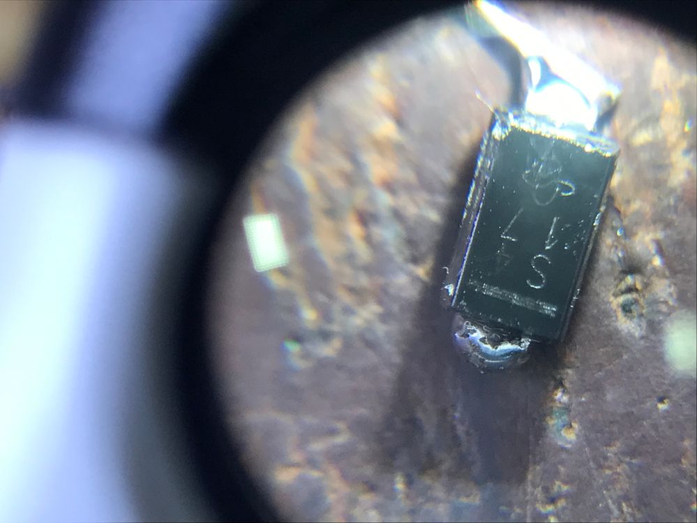

Thank You.
Looks to be a Vishay 40V 3A  SS34-E3/57T
https://www.vishay.com/docs/88751/ss32.pdf
