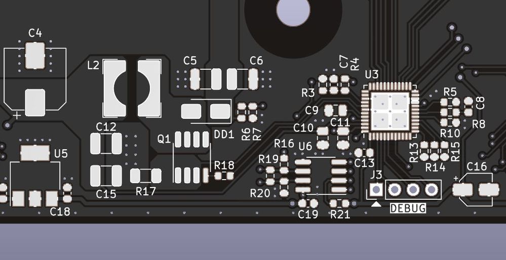

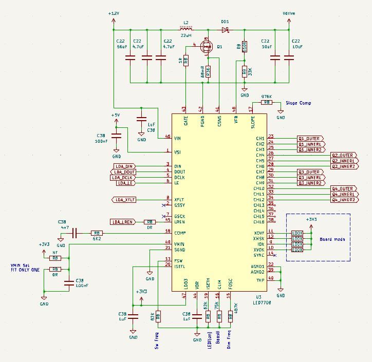

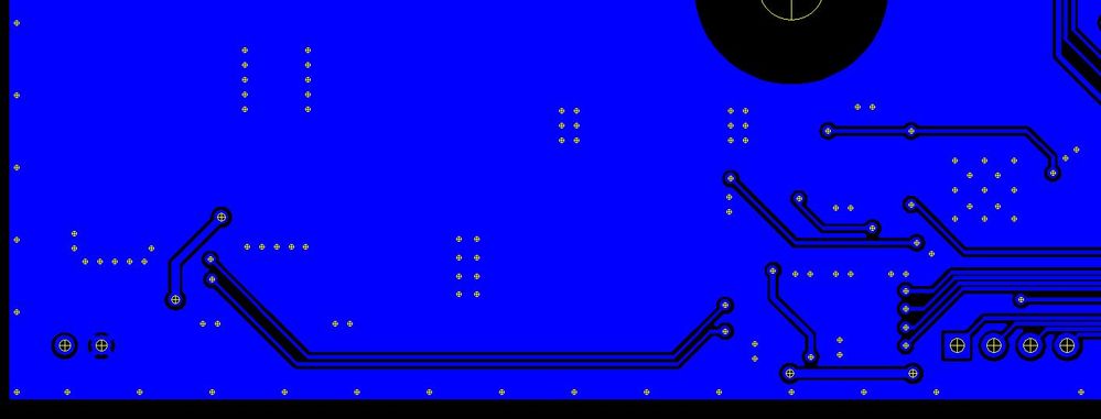

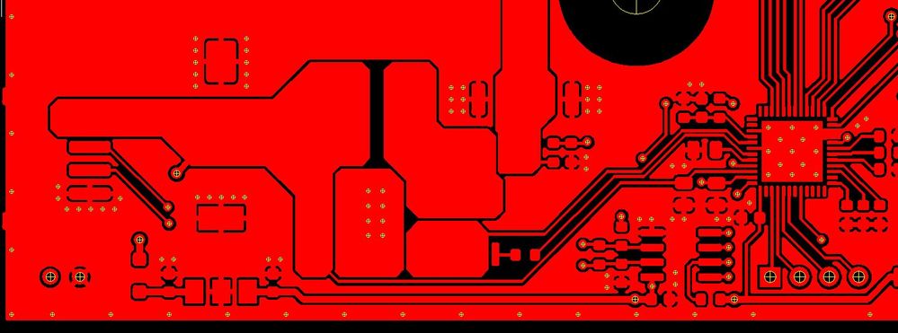

2025-02-13 4:13 AM
Hi Peter, many thanks for picking up our design problem
To give you a bit more general info on our design, I've attached the schematics of the Drive cct, together with the PCB layout.
The main components are:
Input Caps: 56uF Elec together with 2x 4.7uF 50V ceramics
Inductor: 22uH Isat 1.6A (Bourns SRR6038)
FET: 30V 8A (Diodes DMG4466SSS)
Diode: Schottky 60V 1A Vf 0.5V (ST STPS1L60)
Output Caps: 2x 10uF 50V ceramics

Layout
Copper bottom
Copper top
Main design parameters, as used in the spreadsheet:
- Input voltage 12V +/- 10%
- 12 channels, each comprising a string of 7 LEDs, Vf 2V - 2.6V, Iled 20mA
- Expected output voltage; Vdrive 14V - 19V
- typical Dccm ~0.3
- Output power; Pout < 4.5W
The problem symptoms, of the LEDs turning off after a period, feel temperature related. However none of the calculations and measurements suggest there is a power dissipation problem.
The spreadsheet suggests a Pdchip of 480mW, Tj 42degC. Measurement with a thermal camera gives ~44degC.

If I take a closer look at your layout, I can see the 13 thermal vias on the blue rear side, which transport the heat from the LED7708 there. However, the GND area there is separated by two tracks, which reduces the heat transport in the area to perhaps 25% of the possible value. The STEVAL-ILL035V1 also has a few tracks around it, but at a greater distance, so that the heat flow is less impeded. Additionally the EVAL uses 16 thermal vias instead of 13. However, as your thermal imaging camera only measures 44°C, this may not be a problem.

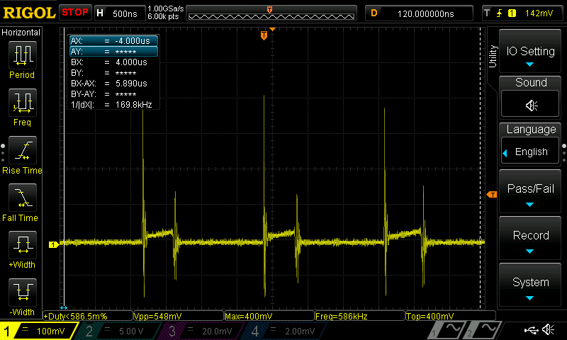

2025-02-13 9:17 AM
An 'overcurrent' situation seems to be the listed error state which best matches the shutdown situation that we're experiencing.
An 'overcurrent' cause may also make sense, in that the situation is made worse by increasing the brightness level and/or the number of strings being driven.
For our setup, Iocp is recommended as 0.75A. It is set to 0.9A with Rclim at 75K. This value has also been doubled to 150K but appears to make no difference.
Attached is a waveform of CSNS measured across the 68mR sense resistor. Could the switching transients be causing an issue? Although the datasheet suggests this is not a latched fault and so should self-recover.
CSNS waveform
