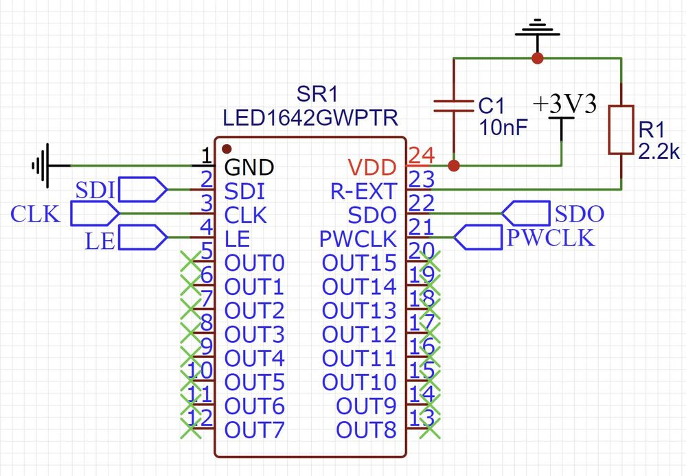

As an "in-progress-check", I have currently placed only two LED1642GWs, each as the schematic below, with SDO of the first chip connected to SDI of the second. I have verified that the CLK, LE and PWCLK are common and within specification, also that the chips are powered and grounded. IMPORTANT: I have yet to connect any loading LEDs so as such, all OUTs are open (NC).
I wanted first to check for cascading operation, however I have found: Data is only output from the SDO of LED1642GW Number 1, when there has been a digital key passed on LE. No data is "pushed through" otherwise. Specifically, if I serialise 2 16bit words to Chip 1's SDI, I would have expected the first word to have cascaded through, however, nothing at all is output.
My thoughts are that either the chips are in an error state given that the loads are open or I have misunderstood something fundamental about their operation. I would greatly apricated some support.

The reason for this was signal degradation on SDI. I had been running my SPI data through an AND gate in order support another active low input, however the transistors I had chosen clearly weren't up to the task. Working with a logic analyser and not a scope, I hadn't realised the issue. Direct input from the SPI had the chip responding as expected.
Sorry!
