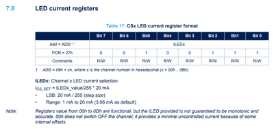

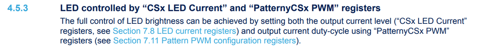

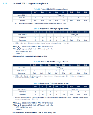

from ds :
So you have to use/set the LED current + PWM , to switch a LED fully off.

from ds :
